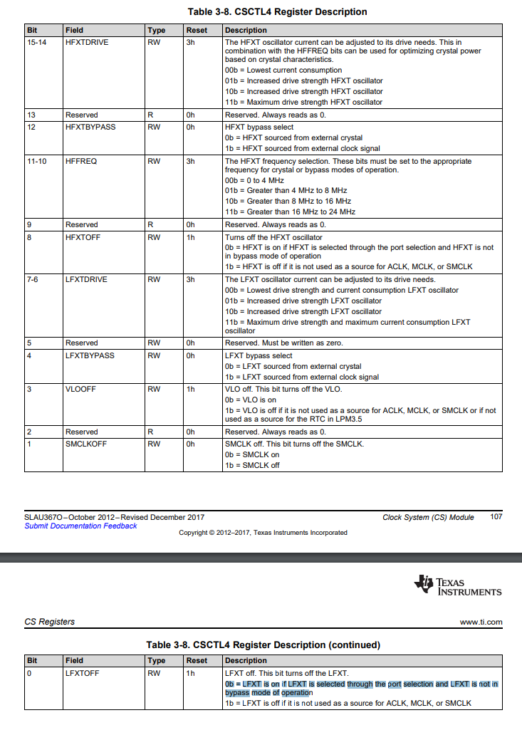

I am currently trying to initialize LFXT to use an external clock signal on LFXIN. I have included the code below, but first I will step through my process:
First we set the PJSEL bits knowing that we are going to use an external oscillator which uses LFXT Bypass:
I then unlcok the CS register space, and set the appropriate configurations for CSCTL1 through CSCTL4. I believe this is where something is going wrong as we want the External Clock, as ACLK will source the UART at 32.768kHz.
1. CSCTL1 is set to DCO 8MHz
2. CSCTL2 is set to LFXTCLK, DCOCLK and DCOCLK for SELA, SELS and MCLK respectively.
3. CSCTL3 is set to Div 1.
4.  CSCTL4 is set to LFXT Bypass and and LFXT Enable (this is where I believe the issue is coming from)

Here is also the description of LFXT and its configurations:
The above code appears to execute nominally, and the issue I run into is when I initialize port 4 pins 2 and 3 to use UART (2 is TxD and 3 is RxD). See code below.
The code runs into an issue and crashes once the code that sets P4DIR has been executed, at which the hardware begins consuming 300uA constant current with 20mA spikes at roughly 13Hz. Note that the hardware is not the issue, as I have tested the hardware with a crystal oscillator, and it works great.
