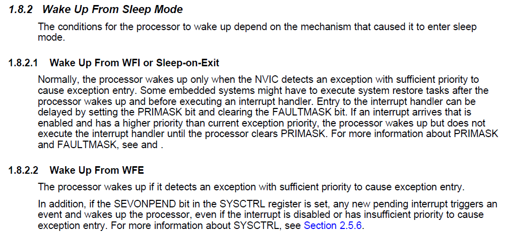

  • Hello Bindu,
    BINDUSHREE M V said:
    Cant I use the SycCtl Deep Sleep mode with RTC??!!
    According to the Technical Reference Manual for MSP432E4 device, this cannot be done. I have attached the screenshot of the relevant TRM section below.
    Whn the system gets powered up I dont want to reset all the pins to default and configure them again.
    If you want to wake up after a certain interval then Hibernation mode seems to be the only option. It is possible to structure your code such that you don't run the  initialization section if the restart is due to a wake up from Hibernation. The "hibernate" example has code that can be leveraged to not execute a section of the application if the wake up is from Hibernation.
    Hope this helps!
    Sai
