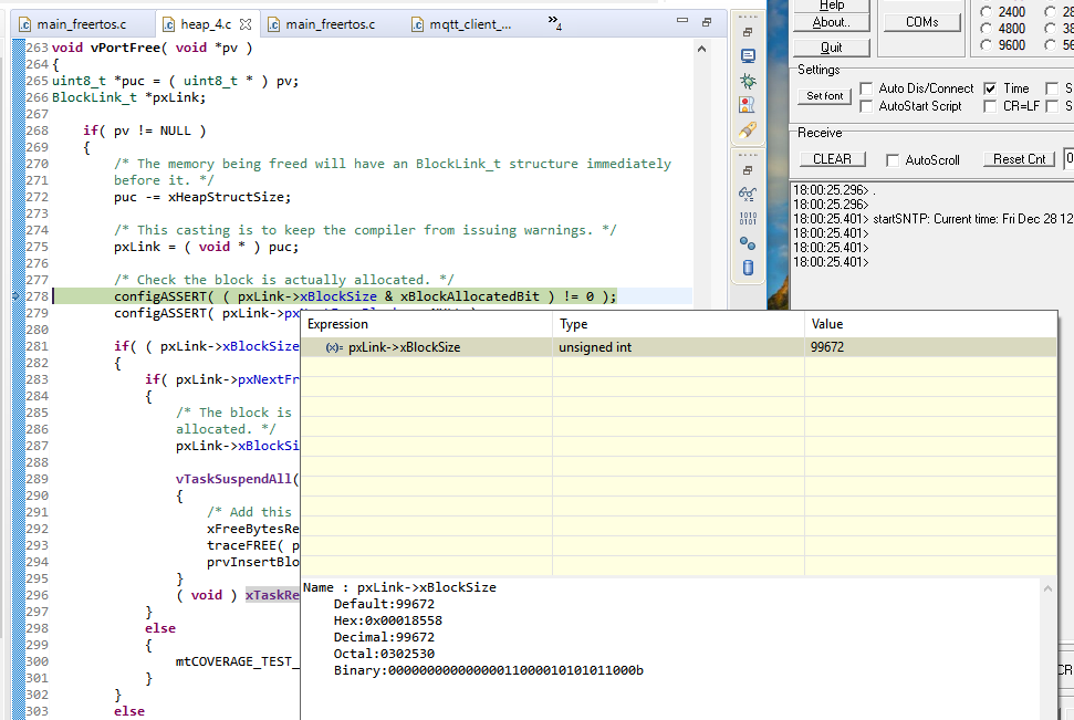

I am using MEP-EXP432E401Y. I am trying to connect secure mqtt with "test.mosquitto.org". I am using mqtt client freertos code form SDK. I follow the instruction from readme for adding secure file. I add that file data in certificate.h file. But my code is stuck in vPortFree when MQTTclient_connection  call.

  • Hi Dinkar,
    Have you made any modifications to the example beyond uncommenting SECURE_CLIENT and adding in the certificate? I downloaded a fresh version of the SDK and haven't been able to reproduce the issue.
    Brandon
    No, I am only modify SECURE_CLIENT and add that server certificate.

  • Hi Dinkar,
    I was finally able to reproduce the issue. I've filed a bug (NDK-319) and this will be fixed in a future release.
    You can fix this in your personal SDK by doing the following (replace SDK below with your install location):
    1. Open the file (SDK)/source/ti/ndk/slnetif/slnetifndk.c
    2. Around line 2183 make the following change
      error:
          if (retVal != SLNETERR_RET_CODE_OK) {
              sCtxPtr->isSecure = false;
              if (initSsl) {
                  mbedtls_ssl_free(sCtxPtr->ssl);
              if (sCtxPtr->ssl) {
                  free(sCtxPtr->ssl);
              if (sCtxPtr->initCookie) {
                  mbedtls_ssl_cookie_free(&sCtxPtr->cookieCtx);
              if (sCtxPtr->initLocalCert) {
                  mbedtls_x509_crt_free(&sCtxPtr->localCert);
              if (sCtxPtr->initCaCert) {
                  mbedtls_x509_crt_free(&sCtxPtr->caCert);
              if (sCtxPtr->initKey) {
                  mbedtls_pk_free(&sCtxPtr->key);
              if (sCtxPtr->initConf) {
                  mbedtls_ssl_config_free(&sCtxPtr->conf);
              if (sCtxPtr->domainName) {
                  free(sCtxPtr->domainName);
          return (retVal);
      #endif /* SLNETIFNDK_ENABLEMBEDTLS */
    3. From here you will need to rebuild the NDK library - if you are unsure how to do this, please tell me what operating system you're using, so I can help.
    4. Now attempt rebuilding and running the mqttclient example in CCS
    Brandon

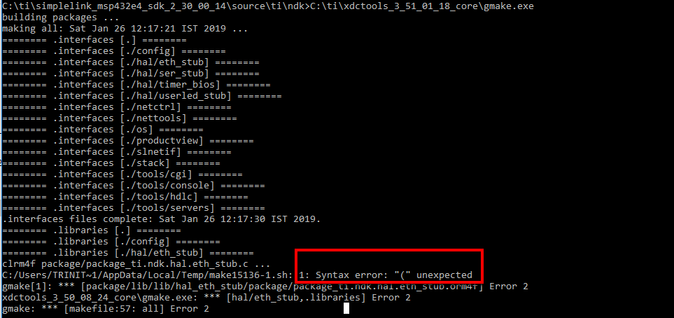

    I am trying to rebuild NDK but i get syntax error. I shared my error screenshot here.
    Dinkar
  • Greetings!
    Is this the first time you've run this command? Were there different errors in a previous execution?
    This is likely a result of an incorrect path in imports.mak.
    Are you planning to use the IAR version of the library? If not, inside imports.mak, comment out the line
    #IAR_ARMCOMPILER        ?= c:/Program Files (x86)/IAR Systems/Embedded Workbench 8.0/arm
    by appending a '#' to the front, like above.
    If you were intending to use the IAR compiler (assuming you already have it installed) double-check that the path listed is correct. If it is, you may try removing any spaces in the path listed in imports.mak as well as moving your IAR installation to a location with no spaces in the path. This has been known to cause issues.
    Brandon
    Thank for reply.
    I rebuild NDK successfully. Now I am able create MQTT connection with "test.mosquitto.org" successfully.
