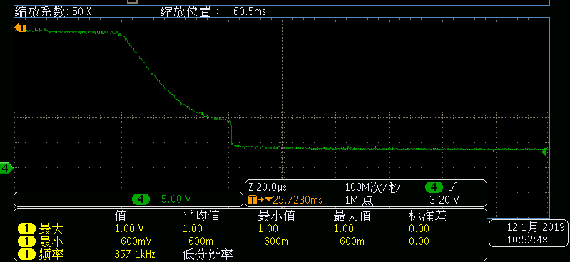

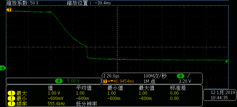

We test it by measuring the total GPIO toggle time after trigger eCMOP from LPM3 mode.
The total time is
a. wake up from LPM3 to active, 10us
b. active mode, jump in eCOMP interruption, ?us
c. execute GPIO toggle in interruption at 4M and 16M separately.
1. Running at 4MHz, it takes about total 40us.
2. Running at 16MHz, total time is 32us.
After reduce the 10us LPM3 wake up time, it takes about 20us to jump in interruption? Is it right? Thanks.
By the way, here is eCOP setting
(1)     ECOMP_INPUT_0/ECOMP_INPUT_1/ECOMP_FILTER_DELAY_OFF/ECOMP_NORMAL_OUTPUT_POLARITY
(2)     The rising edge and falling edge interruption
(3)     HysteresisMode:ECOMP_HYSTERESIS_MODE_DISABLE
  • Hi Daniel,
    Can you give notes of key points on you waveform? what's the signal of the waveform(green one)?where is the wake up trigger signal? How you measure the time spent from trigger to GPIO toggle?
