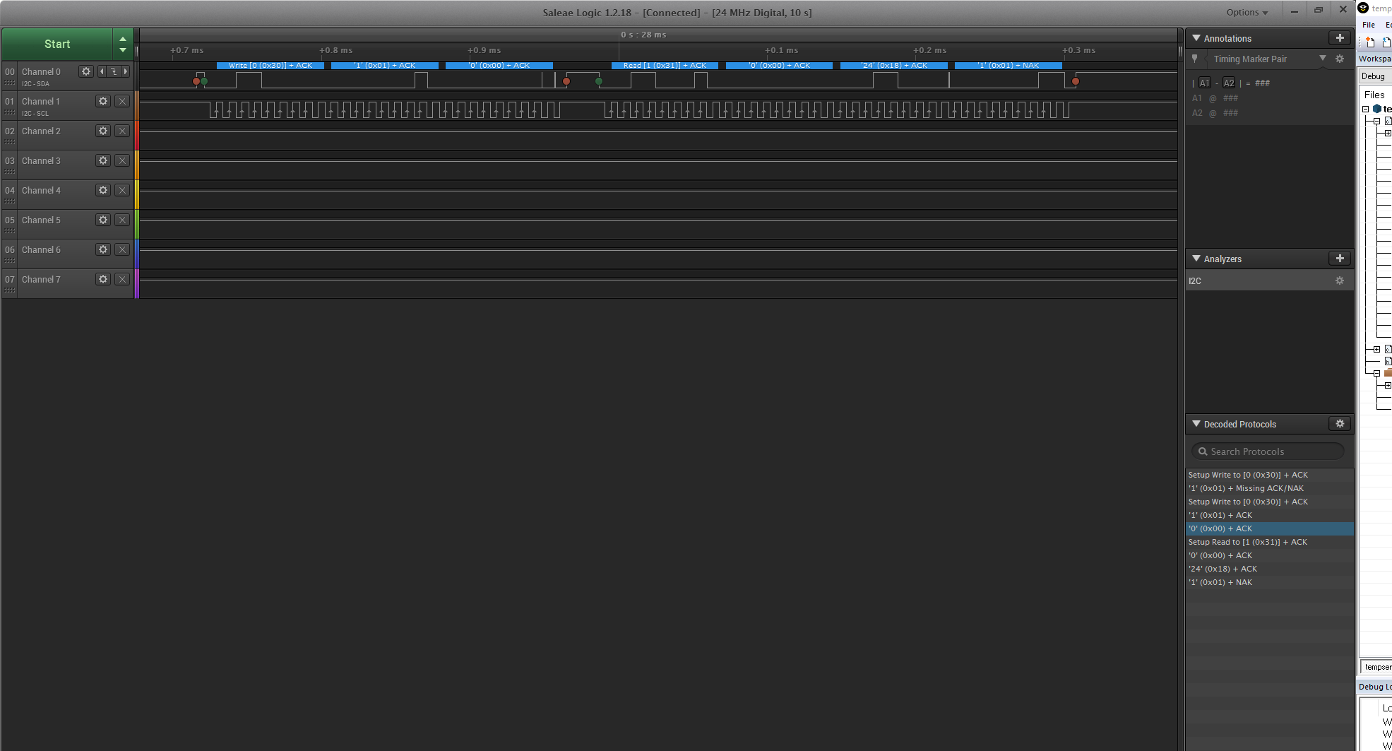

  • Hi Chris,
    I have checked out the resources and I2c Communication Examples and MCP9808 data sheet. But I couldn't find the required results to get temperature value.
    I am facing problem to get the desired results.
    In MCP9808 data sheet in CONFIG Register part where I have to write
    Addressbyte(0x30),Configuration pointer (0x01), (0x00), (0x08)
    and read out Addressbyte(0x31), (0x00), (0x08) as a desired result but I am reading out Addressbyte(0x31), (0x00), (0x18), (0x01).
    I have attached results below which are taken by logic analyzer. Any guidance to help me understand where I am doing mistake will be appreciated.
