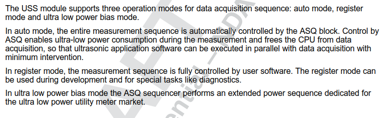

  • Hello Eddie,
    I am referring to the data acquisition sequence modes. AUTO mode, REGISTER mode and ULTRA low power mode as mentioned below.
    Yes! what you mentioned is what I understood from the above description as well regarding the switching control.
    But I see that the Auto mode and Ultra low power mode are same except that the in ultra low power mode we can introduce an additional "holdoff delay" (This is the extended power sequence? ) of max 300us for less power consumption than in AUTO mode.
    So to summarize:
    AUTO mode: ASQ control
    REGISTER mode: Software control
    ULTRA low-power mode: ASQ control + "holdoff delay" (Extended power sequence ).
    is this correct? or are there any additional features in Ultra low power mode which I am missing?
    Jadhav
  • Jadhav,
    Your understanding is correct regarding the modes. By default, in the demo code, we are using the ultra low power mode to show lowest power performance.
