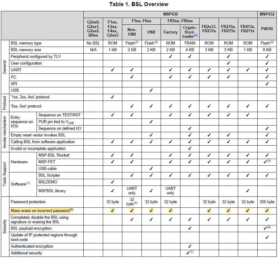

    1. Mass erase using the USB BSL
    The simplest way to trigger mass erase by USB BSL is to use "RX_PASSWORD" command with a wrong password, which would trigger the "mass erase on incorrect password" according to the MSP430™ Flash Device Bootloader (BSL) User's Guide.
    More specifically, in order to do that, please firstly download the latest BSL Scripter here. Then in the package you can find the examples at path .\ScriptExampleWindows\5xx_usb and you only need to take three lines to do the job.
    MODE 5xx USB
    //gives wrong password to do
    //mass erase in the memory
    RX_PASSWORD pass32_wrong.txt
    RX_PASSWORD pass32_default.txt
    Please note that, as highlighted in the document below, the "password" referred to here is BSL password that is located between addresses 0xFFE0 and 0xFFFF, and "mass erase" is performed ONLY on main code flash memory.

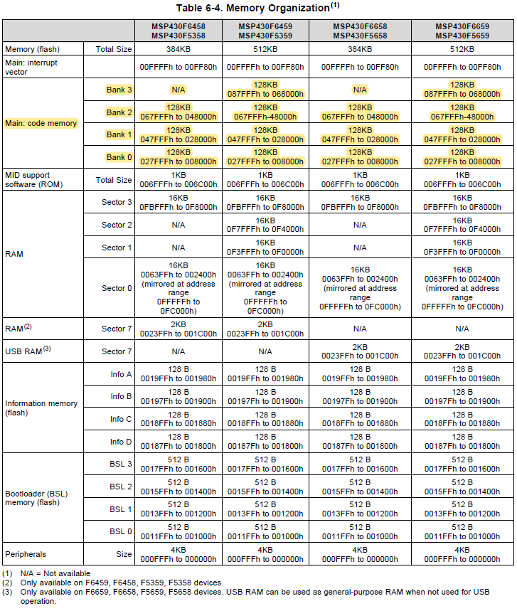

    The USB BSL region is at 0x1000, so what are we writing at 0x2500?
    Thank you,
    Fred
  • Hi Fred,
    By "RX_DATA_BLOCK_FAST RAM_BSL_USB.txt" the USB BSL firmware is programmed to RAM starting at address 0x2500.
    By "SET_PC 0x2504" the program counter (PC) is directed to the USB BSL in RAM. This command: 1) ends the USB BSL session started from BSL flash memory (address range 0x1000 - 0x17FF) and 2) starts a new USB BSL session from RAM.
