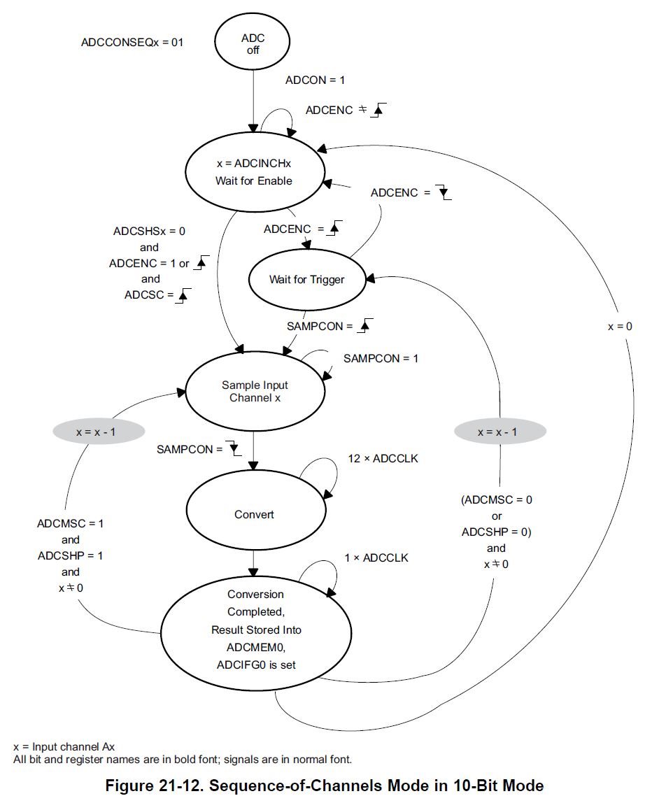

I found the ADC10 of FR2433 doesn't works as the user guider says.
The problem happens on  Repeat-Sequence-of-Channels Mode.
As we know, there is no DTC or DMA in FR2433 . Besides, it has only one ADCMEM. so I need your help clear sth.
1) If  I chose the sample trigger source  is TA1 , not by software(ADCSC),  and there're 5 channels in one sequence.
A rising edge of TA ,will trigger the whole sequence or just only one channel ?
In my head , if set ADCMSC bit,  the rising edge of TA will trigger the whole sequence , or , it just trigger only one channel.
   Am I right?
2)
Does it necessary to toggle ADCENC bit after each sequence conversion  completed in Repeat-Sequence-of-Channels Mode?
3)

  • The ADC sequencing for CONSEQ=3 is shown in the User Guide (SLAU445H) Fig 21-16.
    1) With MSC=1, a single TA trigger will start an unending repetition of sequences (up-arrow to the left). Further TA triggers will effectively be ignored.
    2) No need to toggle ENC, regardless of the MSC setting. (Up-arrows to the left and inner-right).
    3) With MSC=0, each TA trigger will cause a single conversion (in sequence), and the sequence will restart once finished. (Up-arrow inner-right)
    I use (3) routinely with a TA period divided by 5 (in your case), so as to avoid the ADCMEM race (ie, no DMA). I don't get "pseudo-simultaneous" sampling in the burst, but that's ultimately a consequence of the ADCMEM race, not the technique.
    To have a single TA trigger run a full burst, you need to use CONSEQ=1 with MSC=1 [UG Fig 21-12], which does require toggling ENC each round. But now you're back to the ADCMEM race.
    What incorrect behavior are you observing?

  • You can see details in below figure:
