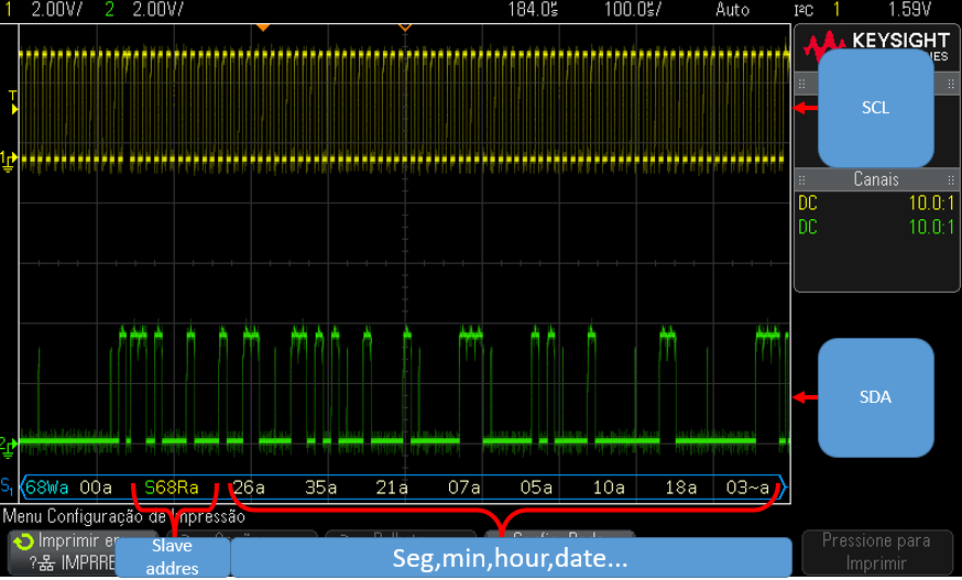

  • Hello friend, thank you for replying. This problem:
    In this code I do the read / write on the RTC via I2C. Each state of the state machine represents the reading of a byte from the RTC. This can be seen in the I2C interrupt service (within if (IFG2 & UCB0RXIFG)).
    After I receive the byte from the RTC to the UCB0RXBUF, I convert the BCD format data and store it in the "relogio" variable.
    Then I get this variable and send it through UART, by UCA0TXBUF.
    And so the operation of the state machine would be: it writes the current date in the RTC (I2C_STATE = 0 to I2C_STATE = 18); and then read the RTC (I2C_STATE = 19 to I2C_STATE = 37); when it arrives in the last state, the state machine returns to I2C_STATE = 19 and stays forever just reading.

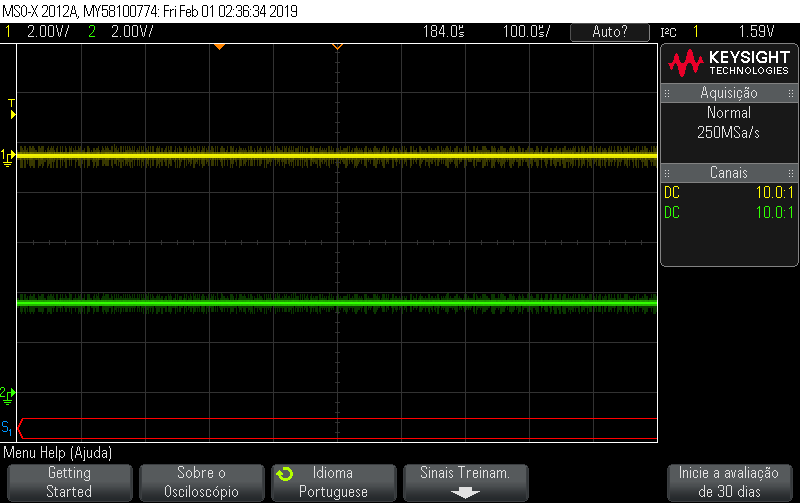

    However the write / read routine in the RTC via I2C does not work when I try to send the data through the UART.
    For example:
    If I comment the UART_Config () function on the main function, the write / read routine on the RTC works normally, as shown in the figure below:
    However if I uncomment the UART_Congif () function in the main function, the RTC stops working, and the I2C and UART stops working. The figure below shows the bus:
    Can you understand how I expect the code to work and what's happening?

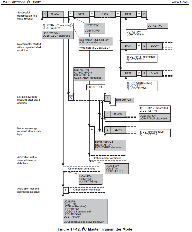

  • Section 17.3.7.4 of the User's Guide says:
    USCI_Ax and USCI_Bx share the same interrupt vectors. In I²C mode the state change interrupt flags UCSTTIFG, UCSTPIFG, UCNACKIFG, UCALIFG from USCI_Bx and UCAxRXIFG from USCI_Ax are routed to one interrupt vector. The I²C transmit and receive interrupt flags UCBxTXIFG and UCBxRXIFG from USCI_Bx and UCAxTXIFG from USCI_Ax share another interrupt vector.
    So you have to use two interrupt handlers, and check and clear the correct interrupt flags in each one:
    #pragma vector = USCIAB0TX_VECTOR
    __interrupt void USCIAB0TX_ISR(void)
        if (IFG2 & UCA0TXIFG)
        if (IFG2 & UCB0TXIFG)
    #pragma vector = USCIAB0RX_VECTOR

  • Hi Stefan,
    Should I work with any I2C receiving code within the I2C receiving routine? That is, within the
    __interrupt void USCIAB0RX_ISR (void)
    Because in the code above, I'm working with the reception of the I2C data within the transmission routine, that is, within the
    __interrupt void USCIAB0TX_ISR (void)
    What is the correct way to perform I2C communication with the RTC?
  • As written above, the I²C receive interrupt must be handled in the USCIAB0TX_ISR handler.
  • Hi Clemens,
    In my code I just monitored the UCB0TXIFG and UCB0RXIFG flags, I did not use the rest of the flags available in UCB0STAT. Maybe this is the problem. I could not understand the operation of this diagram:
    Could you translate this figure into a simple, generic code?
  • Hi Luiz,
    as Clemens showed above, there are two interrupt handler and for that you need to provide the functions:
    This one is called with the UART TX and the I2C RX and TX interrupt and needs to handle this functions
    This one is called with the UART RX and the I2C State interrupt and needs to handle this functions
    __interrupt void USCIAB0RX_ISR(void)
     if (IFG2 & UCA0RXIFG)
    ... else // check I²C state changes e.g. START and STOP bits }
    The reason why your code stuck currently is that you have enabled the UART RX interrupt but not handler for that provided. So the CPU jumps to an undefined location as soon as this interrupt happens.
     Stefan
  • Hello guys,
    I was able to run the RTC via I2C with the UART. I changed the code completely.
    Based on an example IT code for I2C communication. I changed the code for my case and added it to my UART interrupt routine.

    These are the I2C bus signals:
    And these are the signs read on the PC (the print screen was not taken at the same time):
    Thank you very much for your support!
