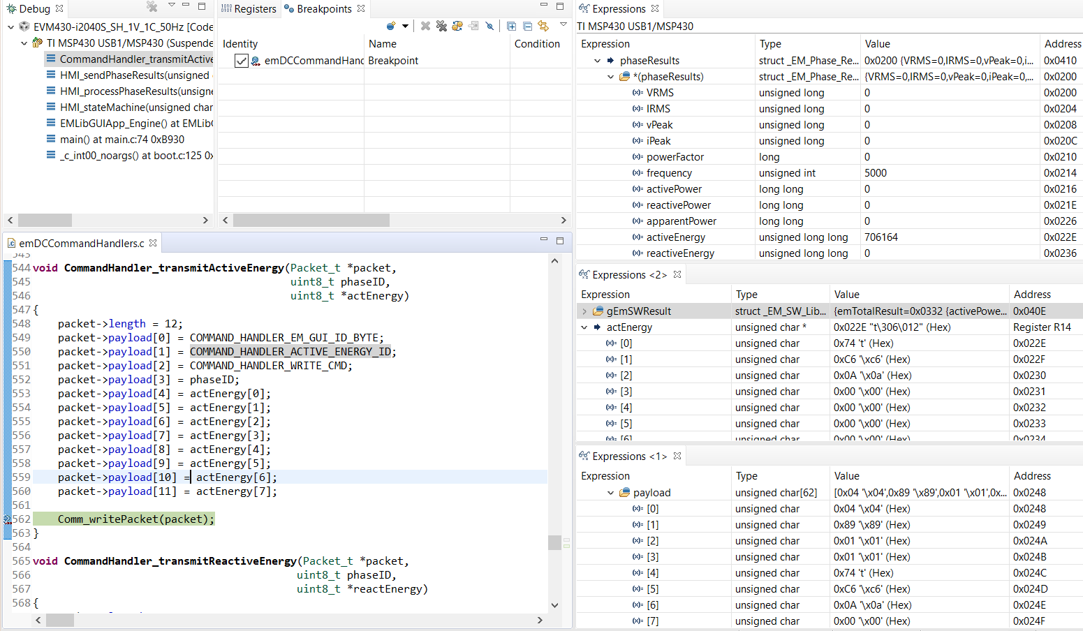

  • Hello Fakruddin,
    We tested the example code here and the data is matching properly.  Please see the image below.  Can you also have a look at these results on your set up?  I want to be sure that you are not comparing aggregated results with active energy.  Also, have you made any changes to the code?

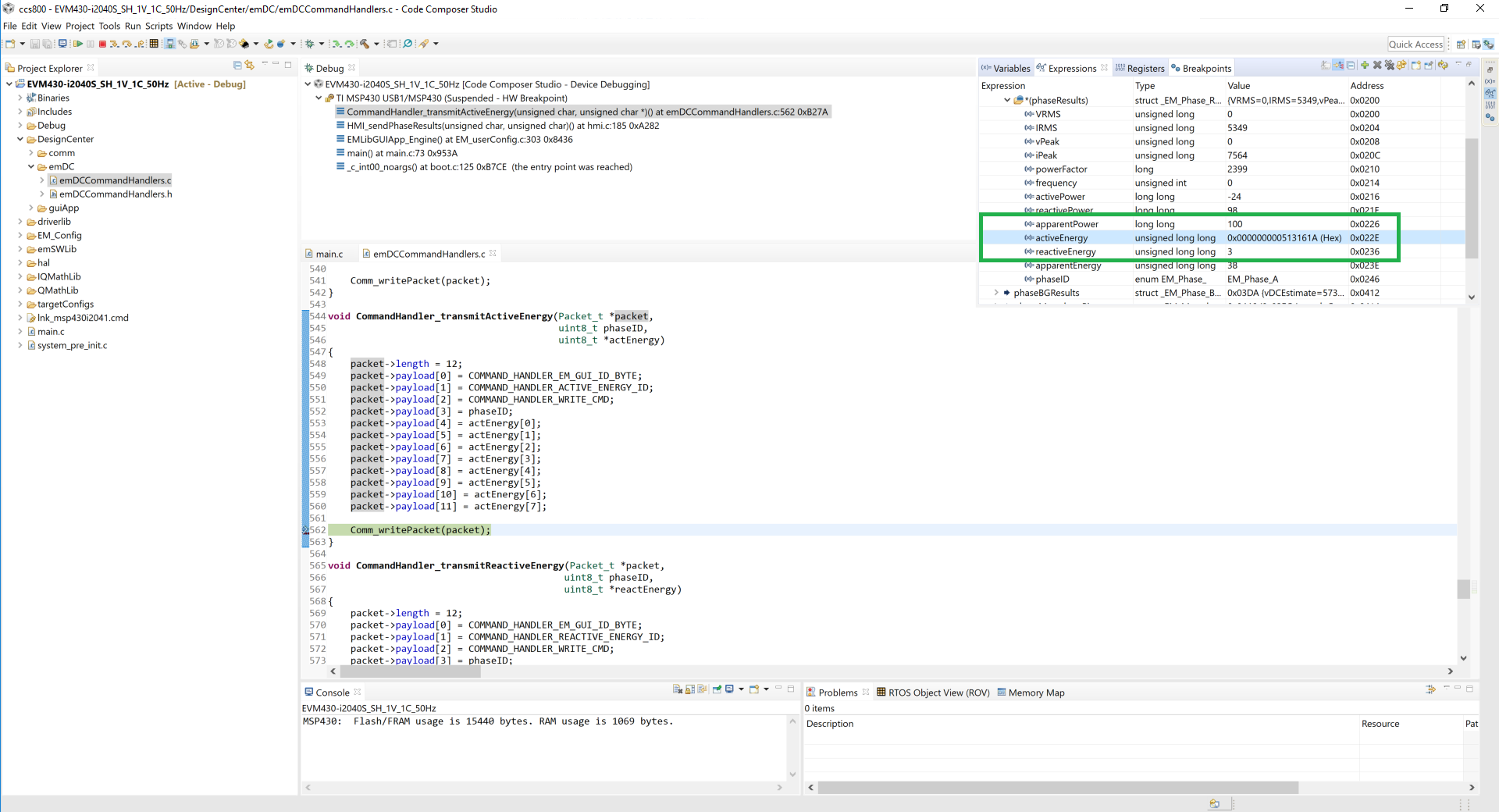

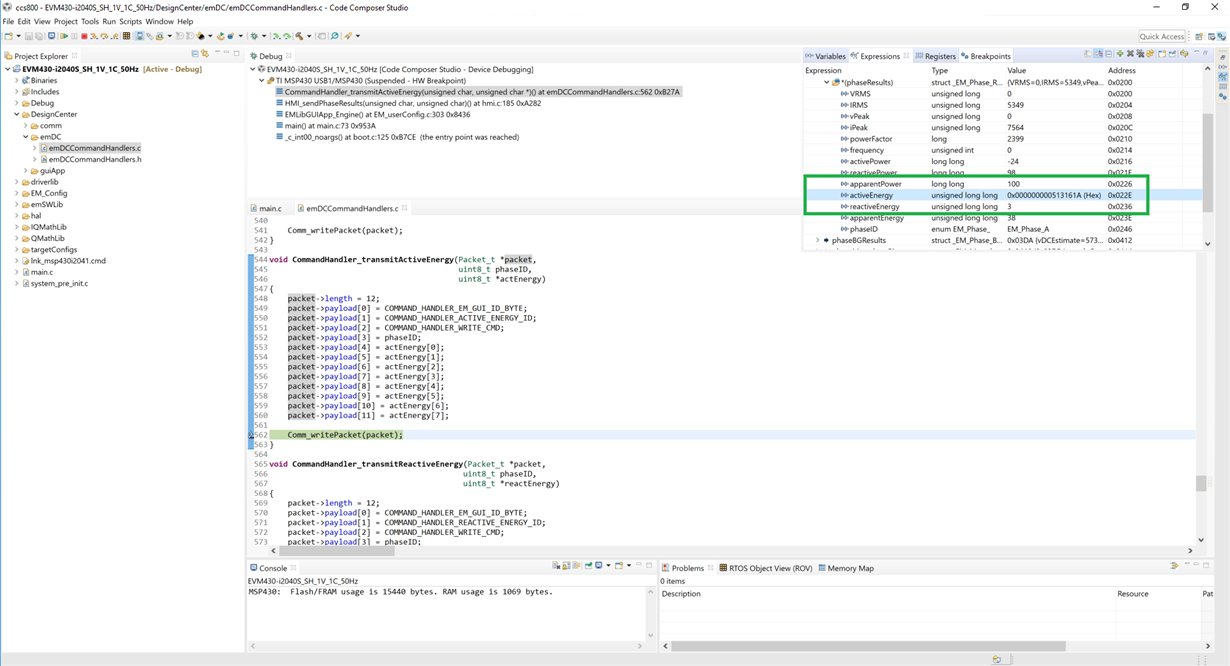

    Unfortunately, I was not able to duplicate your error. In CCS, I put a breakpoint at the "Comm_writePacket(packet);" line inside the "CommandHandler_transmitActiveEnergy()" function in the 'emDCCommandHandlers.c' file.
    Then, I manually changed "packet->payload[4] ... payload[11]" from "actEnergy[0] ... actEnergy[7]" to hex values such as 0x1A, 0x16, 0x13, 0x05, 0x00, 0x00, 0x00 and 0x00. After sending the MCU the ACTIVE command, I confirmed that the UART packet with the command byte for Active Energy (0x89) matched what I changed in the code. To read the UART packets, I used a terminal program called Serial Port Utility and sent over the ACTIVE command one byte at a time at 250kBaud. This triggers the MSP430i2041 to start sending the results to the terminal once a second.
    Next, I undid my changes above and then manually changed the "activeEnergy" expression to "0x000000000513161A (Hex)" with the code halted at the same function. After running to the same breakpoint, I again confirmed that the UART packet matched the changed expression. Here are two screenshots demonstrating my findings.
    Please use the default EMDC project for the MSP430i2041 (without any changes) to generate the source code and then program the device with this code. You should be able to duplicate my results. Perhaps there's an issue with your host MCU that's reading the data from the MSP430i2041.
