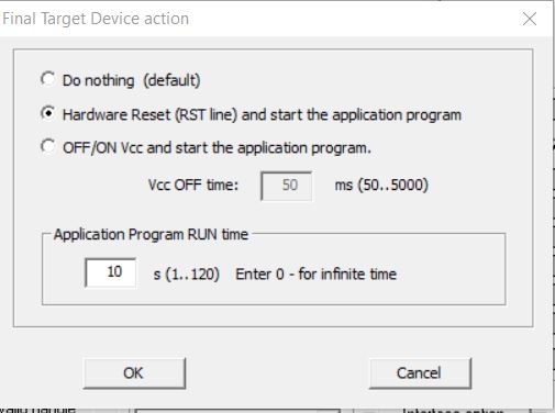

Hey all,
Thanks for reading.  I've got a system using an MSP430G2553 chip and we are seeing high sleep currents.   I am noticing that the TEST and RESET pins are not exactly VSS or VDD.
TEST is not connected to anything and RESET is externally pulled up using a 47K resistor (see below).     We are seeing a high sleep current during LPM4.     RESET is measuring about 14mV -below- VDD     and     TEST is measuring about 4mV above GND.  I don't know if they are to blame for the high sleep current.
The datasheets don't mention anything about specific settings for RESET and TEST  before going to LPM4.   Do any of you have experience with this odd issue?
We are using TEST and RESET to program the MSP through Spy-By-Wire.
