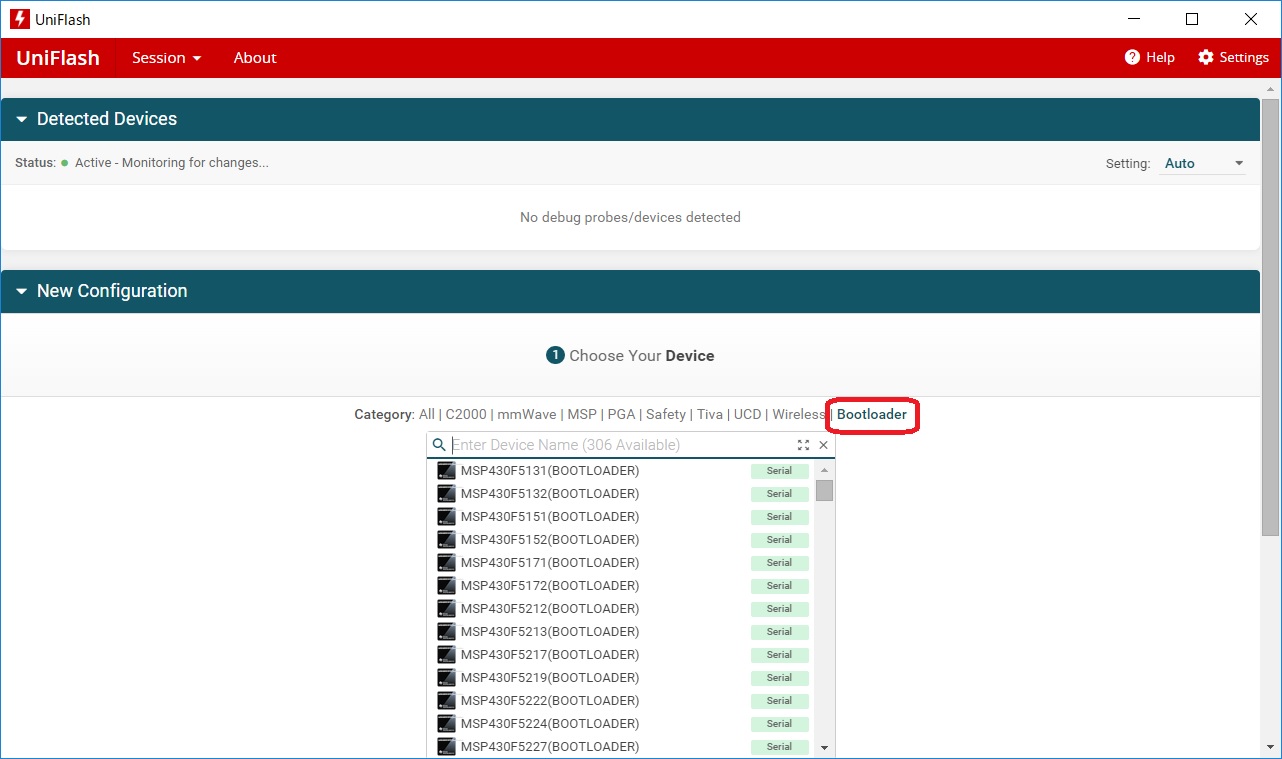

  • Hi Peter,
    I installed the latest Uniflash v4.6 and found that the new menu "Bootloader" was added as below. But it seems that BSL supports only F5x/6x and FRAM devices.
    Could you please confirm it again?
    Uchikoshi
  • Hello Uchikoshi-San,
    my apologies. You're correct. Unfortunately the F1xx devices are not supported, neither by the UniFlash nor by the BSL-Scripter.
    The only thing we offer for BSL of F1xx devices is the BSLScripter-3.4.0-windows-installer.zip package, which you can download from software-dl.ti.com/.../index_FDS.html .

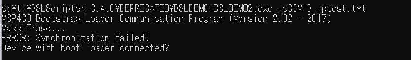

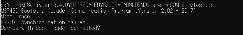

  • Thank you for your proposal. It looks that BSLDEMO2 can work with MSP-FET but could not succeed. Adding to no document for "BSLDEMO2.exe", it seems to require some special command(UART baudrate) to configure MSP-FET to BSL mode. I am not sure how I can configure.
    Now I used MSP-GANG instead of MSP-FET and used a GUI for MSP-GANG which can support BSL mode. It looks like working fine at the moment.
    For alternative solution, please let us know how to configure MSP-FET to BSL mode for old device like F1101. Below is the capture using BSLDEMO2. I believe the wire connection is correct since MSP-GANG can program it.
    Uchikoshi

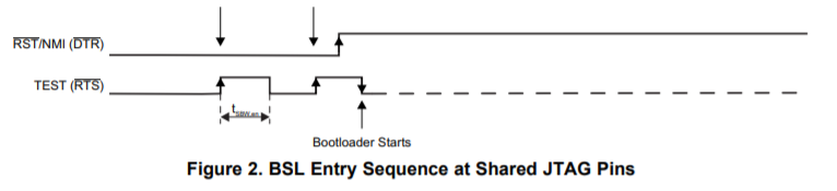

  • Gents,
    to give you brief update. The root cause of the problem seems to be the entry sequence for the BSL.
    We have tested it with an old no longer available tool for RS232 interface. There the Demo example works. The difference we found so far, is the entry sequence, comparing it with the BSL rocket.
    Please see here the different sequences
    This is the entry sequence with the old tool.
    And this the sequence applied by the BSL rocket.
    We'll try to fix this, but it will probably take some time, as for the release, we need to go through testing it for other devices and GUIs....

  • Peter, I don't understand. Does the first scope image show what the MSP-FET produces as the hardware invocation pattern? I don't see how that could work for any part, even the new ones. It only has one pulse on Test, which doesn't match any of the valid patterns in slau319 and 550. Is that the pattern it produces even with BSL-Scripter and the newer parts?
  • Hi George,
    the first image shows, as commented, the signals of the internal BSL tool for an RS232 interface no longer available since many years. It is showing a low pulse on the RST and a high pulse on the Test pin.
    The MSP-FET is not included yet in the tests, as it is not expected to work anyway.
    Best regards
    Peter
