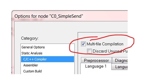

  • This issue was resolved, simply make sure to mark your project with "Multi-file Compilation" option.
    Also use this post as reference:
