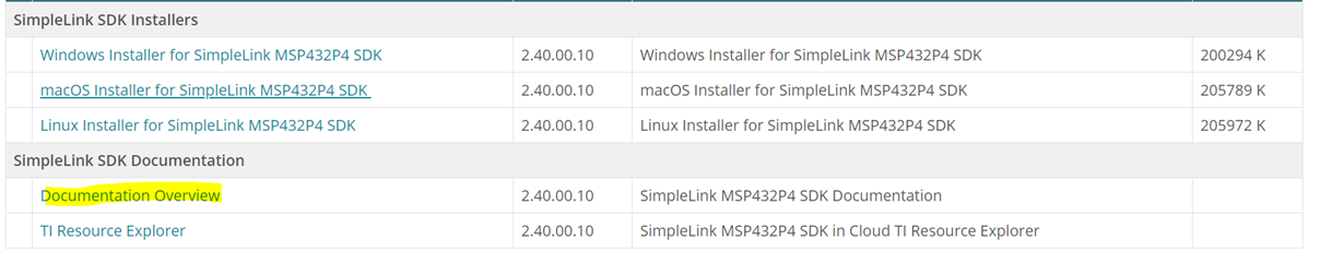

  • Hi Robert,
    Look in the "Documentation Overview" doc (link is in the SDK Release Notes or on the highlighted link on the SL SDK page)

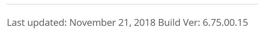

    You can then click on the TI-RTOS Kernel (SYS/BIOS) release notes to get the version.
    The version is at the top and the version/date are at the bottom of this page.
    I'd recommend staying with the SYS/BIOS version that is shipped in the SDK. You can use a newer version, but he have not validated against it. If their is a major issue with a release, we'll address it in the next quarters SDK.
