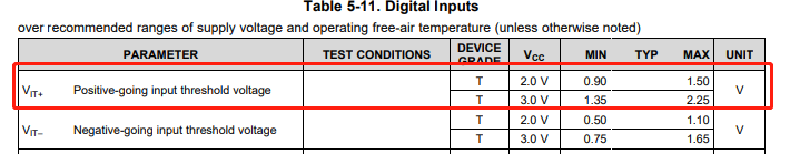

There is a 1.8V power supply and the serial port is connected to the MSP430. Whether it will cause the high level is not recognized.
