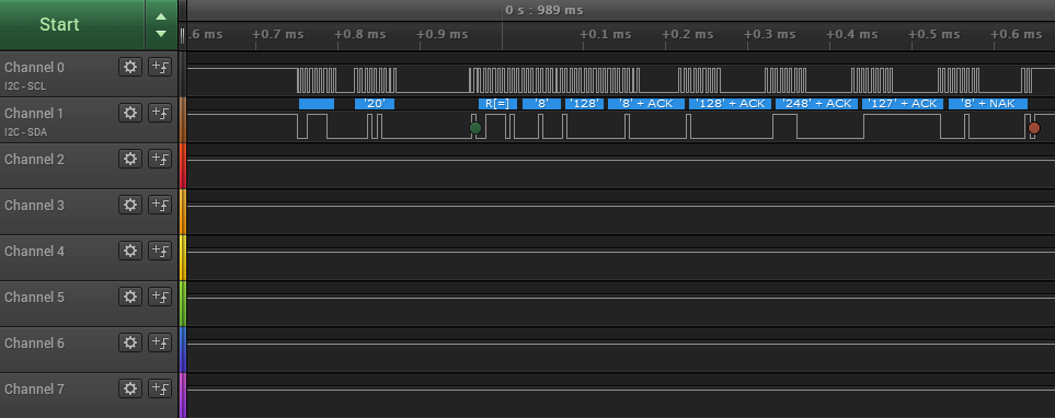

I have a project work with MSP430FR2433 and LIS3DSH
I search some code in internet and edited it.The problems is if I read ONE byte, it worked. I sent WHO IS command and the sensor sent exactly byte I want.
But if I've tried read multi bytes. The sensor sent wrong data and after that, If I read one byte, it sent wrong data, too.
My code is here.
Could you help me to fix my code?

        rx_val = UCB0RXBUF;
        if (RXByteCtr)
          ReceiveBuffer[ReceiveIndex++] = rx_val;
          RXByteCtr--;
        if (RXByteCtr == 1)
          UCB0CTLW0 |= UCTXSTP; //UCTXSTP;
        else if (RXByteCtr == 0)
          UCB0IE &= ~UCRXIE;
          MasterMode = IDLE_MODE;
          __bic_SR_register_on_exit(CPUOFF);// Exit LPM0
        break;
