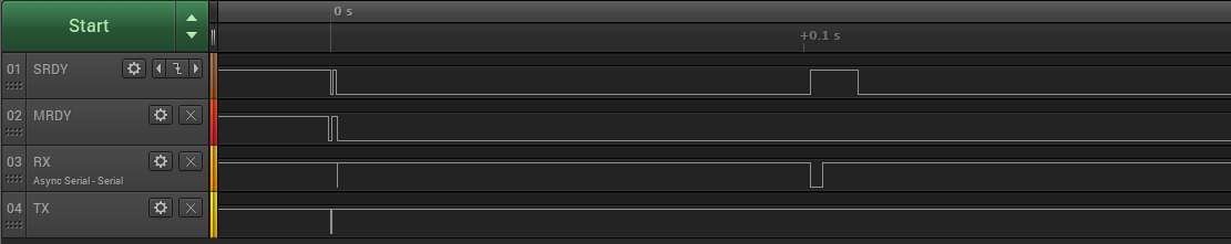

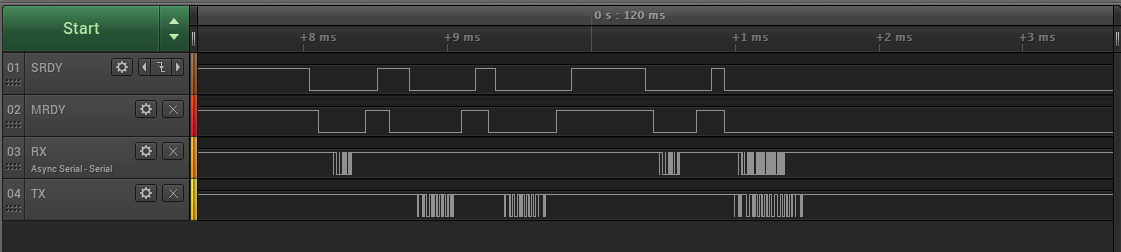

For the baud rate of 460800, the response is unstable. The SAP task receives the 'PUI' sometimes and for other times there is no 'PUI'. Please refer to the attached images,
Case 1:: Baud rate = 460800, received PUI
Case 2:: Baud rate = 460800, Didnt recieve PUI. The MRDY and SRDY pins remain "LOW".
Case 3:: Baud rate = 921600, No data sent from SNP, MRDY and SRDY remain LOW.

    For baud rate of 460800, I recieve "PUI" event at times and it doesnt work other times.
    I have attached the logic analyzer capture for 460800[both the cases of working and Not-working] and 921600 baud.
    I assume the problem is MRDY and SRDY pins are LOW and donot return to HIGH state. Can you check the images and comfirm?
    Thank You,
    Tejas
