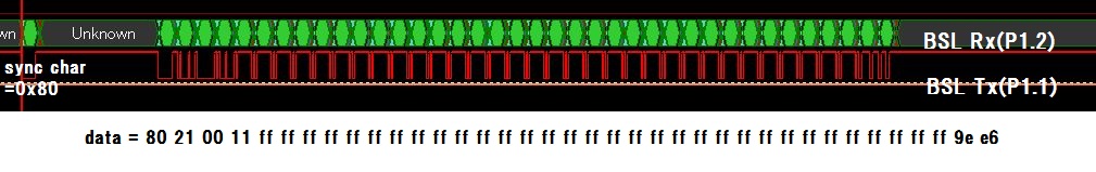

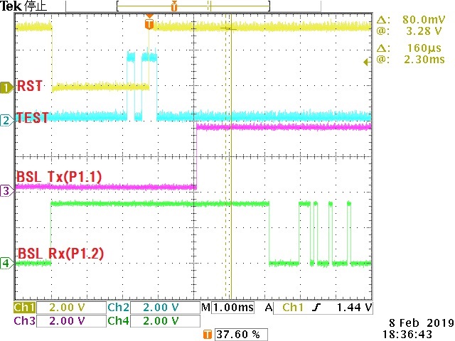

    . I'm writing BSL.00.07.05.04.txt to MSP430F5514 and trying to update using BSL(UART).
    . Writing BSL.00.07.05.04.txt to MSP430F5514, verify is also successful.
    . wave_00.JPG : Attach the BSL entry sequence waveform.
    . wave_01.JPG : There is no response to that command that don't require password.(change baudrate)
    . wave_02.JPG : There is no response to that command "RX password to unlock BSL".
    In the first place, wave_01.JPG and wave_02.JPG have no response to synchronization character. (1byte:0x80)

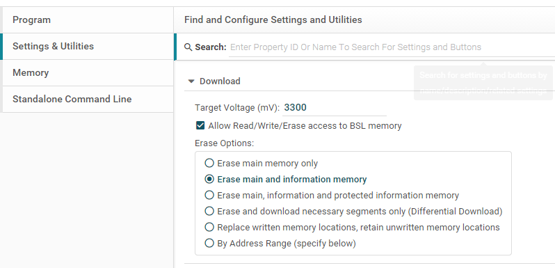

  • Hi Takayuki
    I have test the code today and it works well. When use the uniflash to down load the image you should set the Uniflash like this
    When you finished it will appear success like this
    When I finished the image download I use the BSL rocket (You can also use the MSP-FET) to do the mass erase with the UART BSL and it is success(I have attached the .txt file that be used by the BSL script
