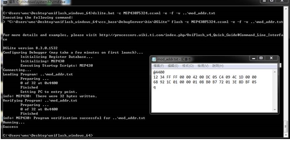

  • Hi zrno soli,
               I programmer main code before. Base on your suggestion, we create mod_addr.txt file to programmer memory range 0x4400. The screen show as below.

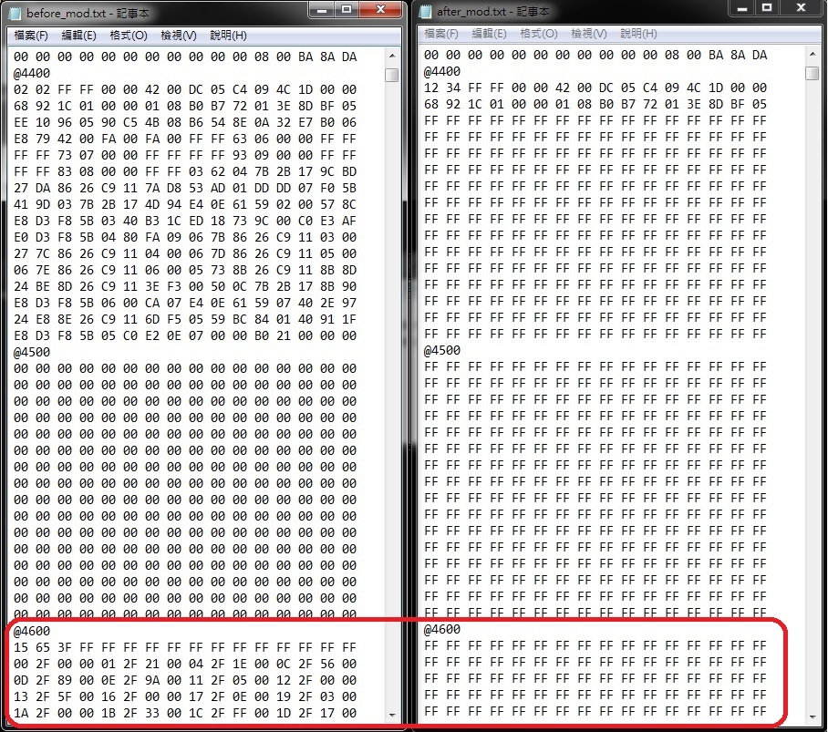

    As below screen show are before & after memory comparison. but the data after @4420 will be set to “FF” to the end of memory.
    Would you and suggestion how to not modify other flash??
  • I see that you want to update part of flash memory. I don't know how, but I guess that uniflash can be configured (maybe it is by default) just to erase flash segment requested by txt file memory area. In this case you can leave empty (erased) hole (segment size)  in your program with initial setup on 04000h. Later only this segment will be updated (erase/write). Other solution is to read original segment contest from device, generate text file (segment size) with updated/replaced data, and write it back to device

  • I am coding in assembler, and not using TI software / hardware tools, so I don't have example for you. I would chose 1st option, and in assembler I would declare segment like...
    org 04000h
    dw 0FFFFh, 0FFFFh... initial data ... 0FFFFh, 0FFFFh ; initial fill for updatable flash segment
    For both options, flasher will erase / write one segment. 2nd option will do segment read before update. Any FET should do this job in 1 second with automated script, so I don't see from where you get wasted time in the factory line.
