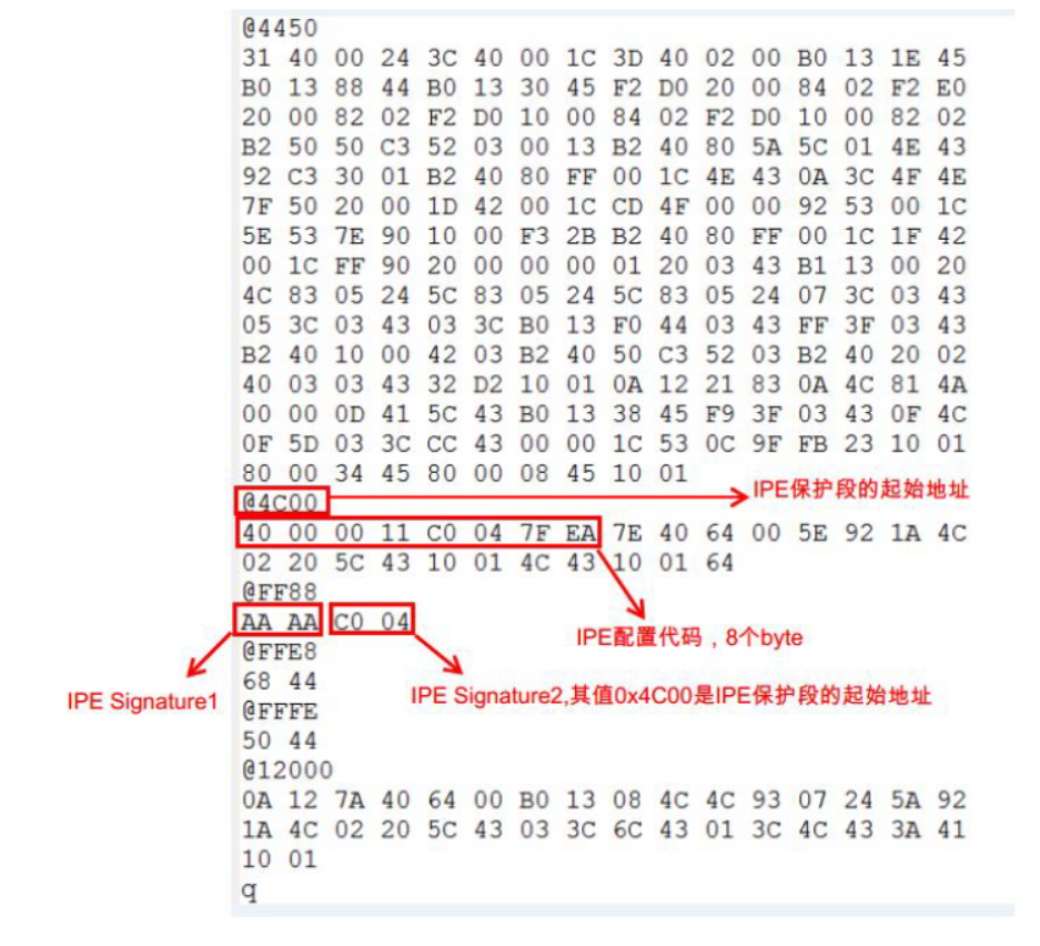

3) I have carefully read the IPE charpter in user guider,and know well of the IPE_INIT_structure.The boot code will tell whether the  IPE Signature1(0xFF88) is 0xAAAA; if YES , IPE signature2(0xFF8A)
actived. and it points to the IPE_init_structure. I believe the content of IPE_Init_structure will load noto registers such as MPUIPC0、MPUIPSEGB2、MPUIPSEGB by boot code.The output(.txt)  of the example
codes provided by TI is sth like this:
When this code download onto chip, reboot the MSP430 .... the IPE actived.  But...this methord only sovle the application that the coder knows exactly  what data need to be protected ,  maybe like this way:

    a) the secured nonvolatile system data area is the IPE protected area. You know the signature 2 include the start address of the IPE
    b)The IPE is active before the application runs. In the UG it just says"The boot code can preload user-defined setting before the start of application code. This ensures that the encapsulation is active before any user-controlled accesses to the memory can be performed." For more details is like "The bootcode performs a sequence to ensure the integrity of the IPE structure pointer. On bootcode execution, a valid IPE Signature 1 triggers the transfer of the IPE Signature 2 (IPE structure pointer source) to a secured nonvolatile system data area (saved IPE structure pointer)." For more details it don't say and I don't know it. Sorry about that.
