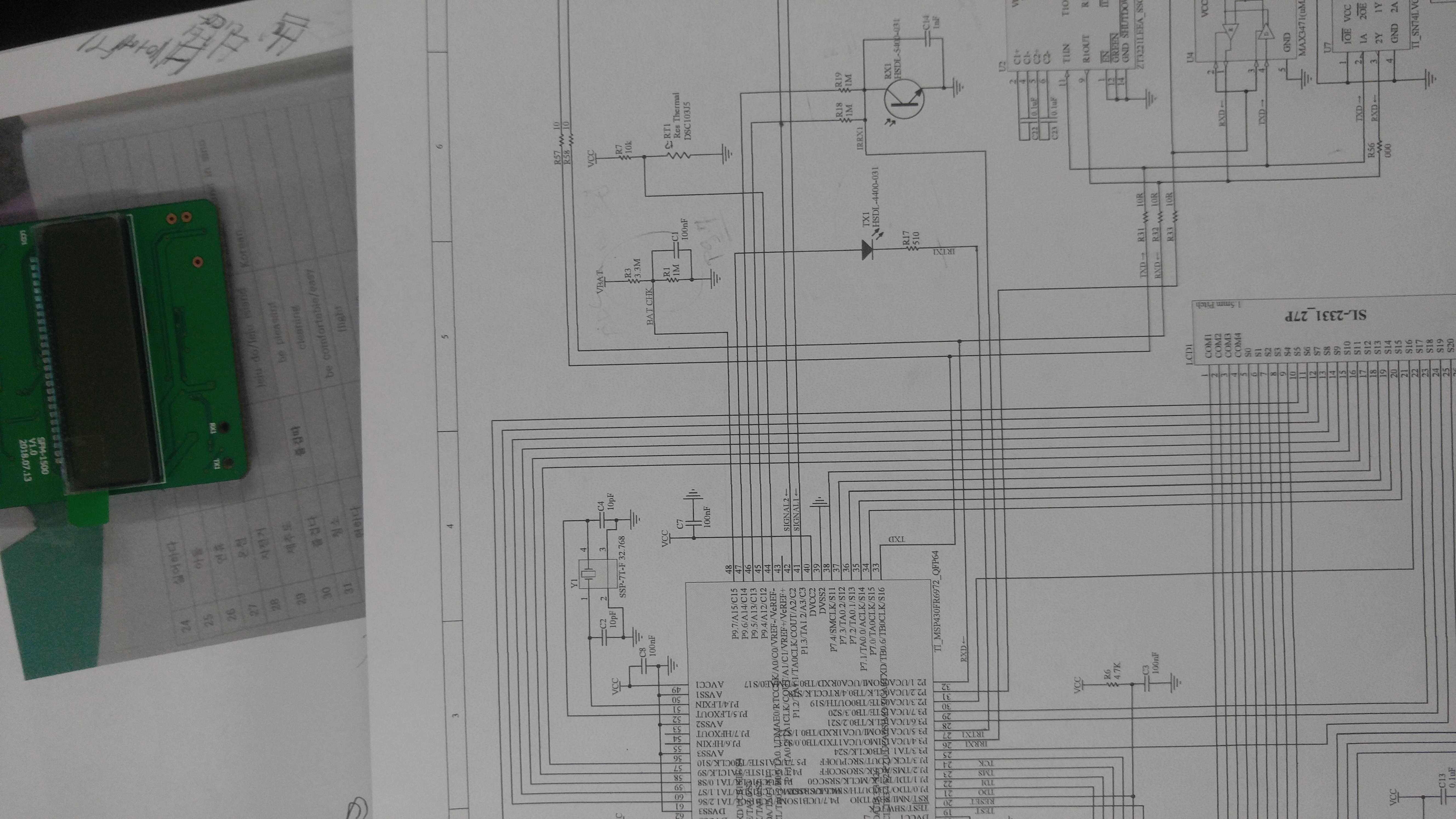

I am using MSP430FR6972 Microcontroller.
I am using IRDA program. (IRDA Module : HSDL-4400-031 & HSDL-5400-031) .
There is a customized board, I have to make program according to that board.
I have made partially, actually I am little confused to make full program.
Can you please help me.

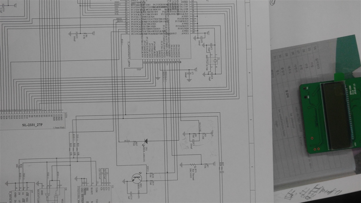

I also upload the circuit.
(In the circuit there are more pins, needs to be added).
Can you please please help me to solve the problem. (any code).
Srijit
    If this circuit is wrong,
    please suggest me with new circuit as well as program(with this IR Module).
    Srijit.

  • Hi JD,
    Thank you for your reply.
    Basically I need two help.
    1 ) I want to make the IRDA connection with MSP430FR6972 using UCA1 communication.
    (Actually the schematic I uploaded, I do not know is correct or not ?
    OR
    Any modification in the connection in that schematic ?)
    2) How to make program .(if you can help me with any code)
    I was checking the IRDA datasheet, but it is confusing to me.

  • Hey Srijit,
    So after some searching, I was able to find this App note on implementing IrDA on MSP430: www.ti.com/.../slaa202b.pdf
    Unfortunantly, it doesn't use a MSP430FR6xxx device, so you would have to port it. Also, it looks to being a IrDA transciever so their hardware connections will be different from what I see in your schematic.
    JD
