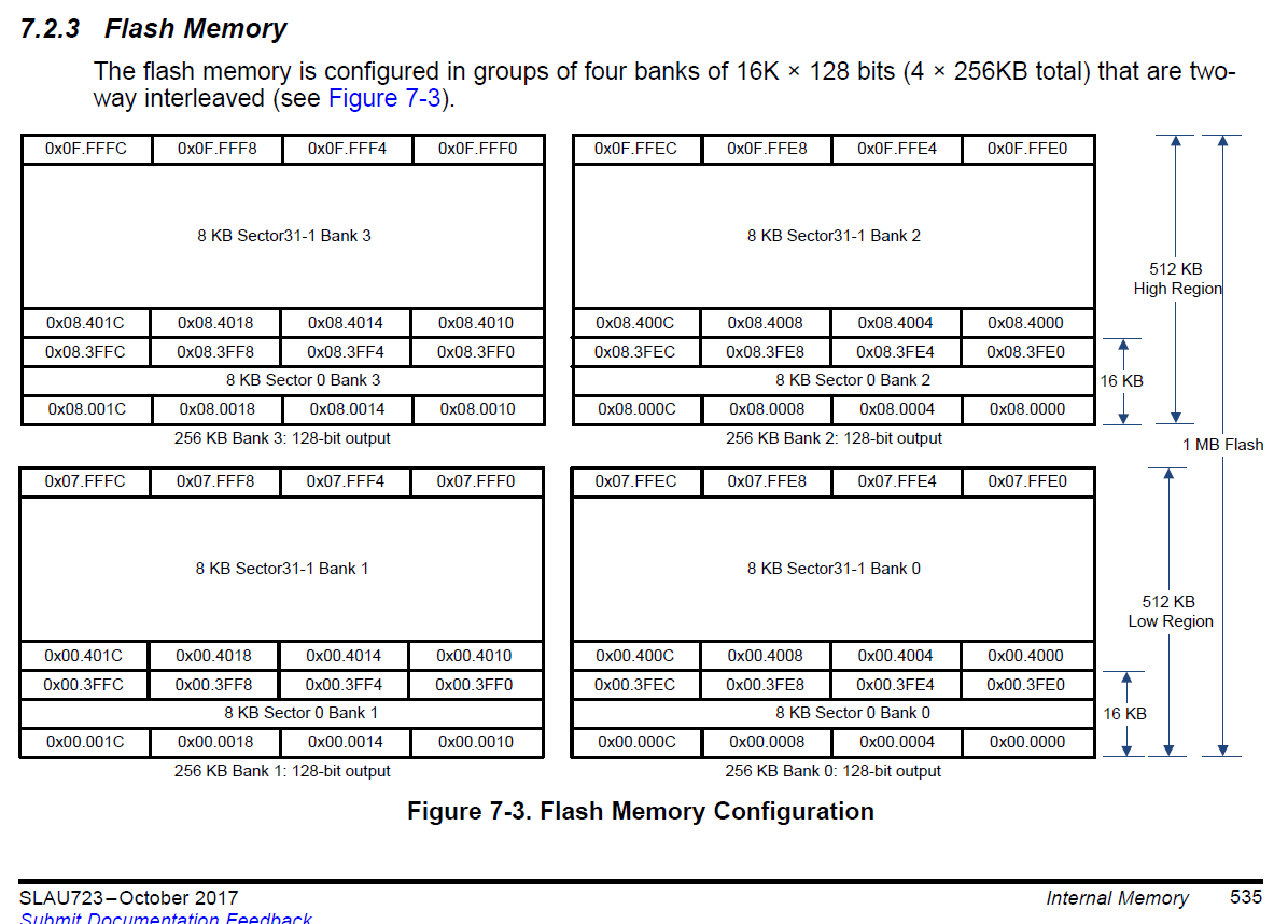

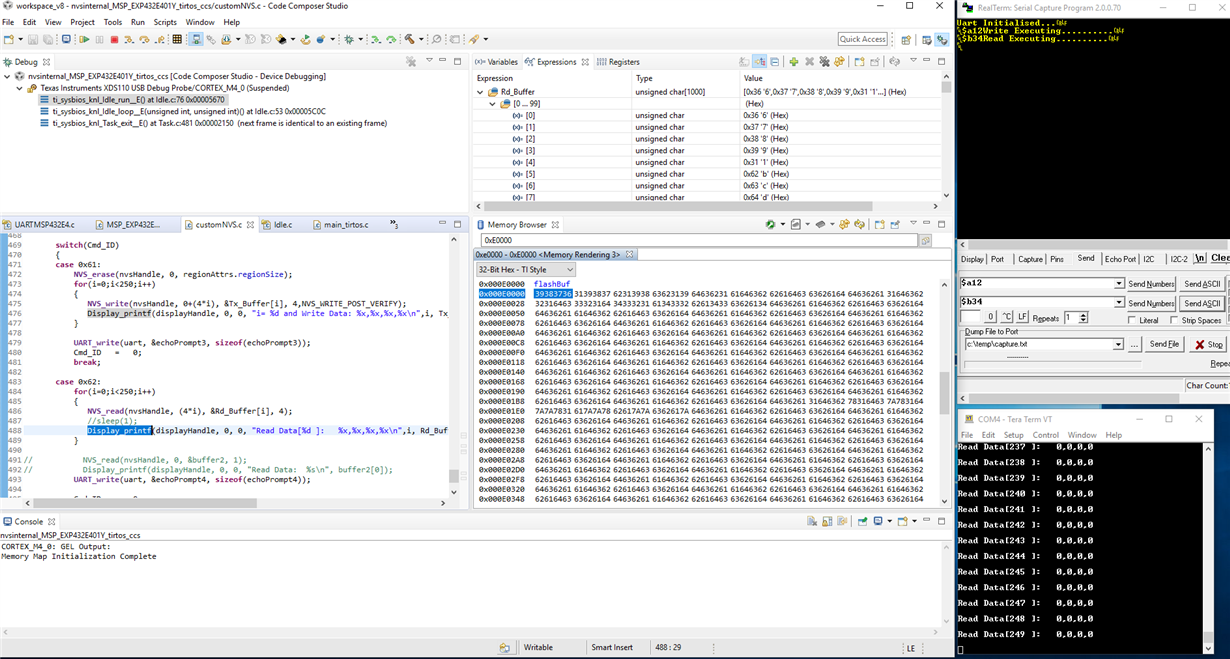

I am using "nvsinternal" program for reading and writing the flash & it is working fine.
However i changed the code for writing and reading the 1000 bytes.
And my code is as follows.
Initially i am sending data for writing and then sending data for reading.
so here while reading, i am able to read the five bytes correctly and remaining all are coming as zeros instead of actual data.
First of all let me know whether the way of writing the code is right or not and also suggest me the reason for reading  properly 5 bytes only.
Thank you
Kalyan.
    I do not have a reason for only 5 bytes being properly read. I do not see any erase routines in your code. Please note that the write process only changes 1's to 0's, so it is important to erase (0 to 1) before writing to the space.

    the above initialization means that the flash is divided into 8 chunks of each size 16kB?.
    Thank you

    I could not get the code to run and will need to look into the errors.
    In the board file you should see that the space flashBuf is being set aside for the application.
    #define SECTORSIZE       (0x4000)
    #define NVS_REGIONS_BASE (0xE0000)
    #define REGIONSIZE       (SECTORSIZE * 8)
     * Reserve flash sectors for NVS driver use
     * by placing an uninitialized byte array
     * at the desired flash address.
    #if defined(__TI_COMPILER_VERSION__)
     * Place uninitialized array at NVS_REGIONS_BASE
    #pragma LOCATION(flashBuf, NVS_REGIONS_BASE);
    #pragma NOINIT(flashBuf);
    static char flashBuf[REGIONSIZE];
    Each sector is 16Kb with 8Kb in each bank.  Since the region base is 0xE0000, this will be in the high region and sectors 24-31.
    Chris
  • Can you confirm this is what you are seeing?
    (1) I can see the correct value being written to in Flash
    (2) I can also see the correct value being returned to Rd_Buffer[] by the NVS_Read API
    (3) Display_printf is printing '0' instead of the content of Rd_Buffer[]
    Chris
    In both the write and read APIs you are multiplying the offset to the NVS region but you are not multiplying the index of the buffer being written to or from.
    NVS_write(nvsHandle, 0+(4*i), &Tx_Buffer[i], 4,NVS_WRITE_POST_VERIFY);
    NVS_read(nvsHandle, (4*i), &Rd_Buffer[i], 4);
    NVS_write(nvsHandle, 0+(4*i), &Tx_Buffer[4*i], 4,NVS_WRITE_POST_VERIFY);
    NVS_read(nvsHandle, (4*i), &Rd_Buffer[4*i], 4);
    Chris
