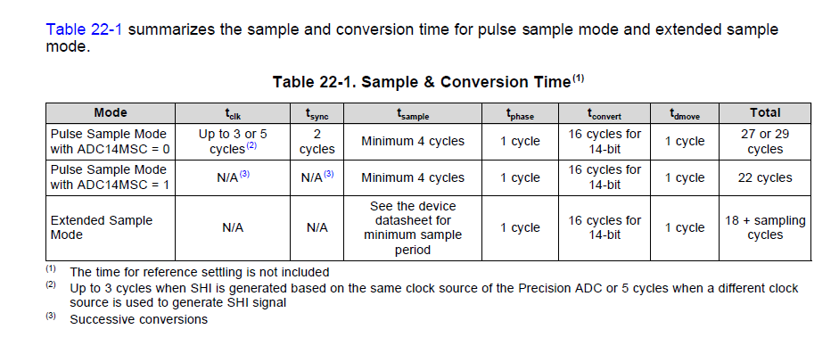

ADC14_initModule(ADC_CLOCKSOURCE_SMCLK,ADC_PREDIVIDER_4,ADC_DIVIDER_5,0); //40K

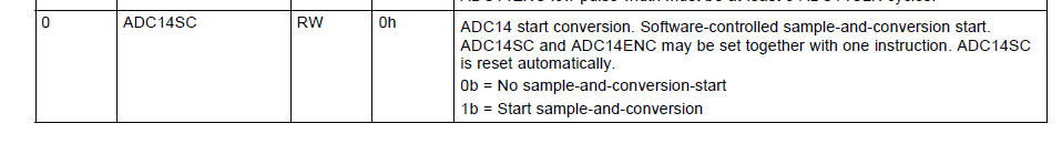

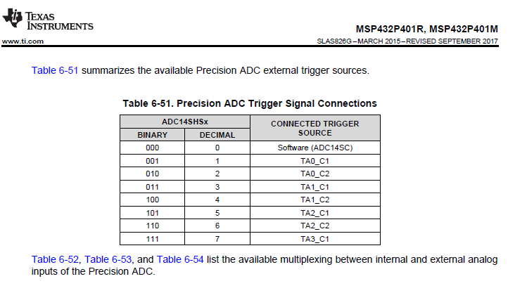

ADC14_setSampleHoldTrigger(ADC_TRIGGER_ADCSC ,false);
ADC14_setSampleHoldTime(ADC_PULSE_WIDTH_64,ADC_PULSE_WIDTH_16);

ADC14_enableSampleTimer(ADC_MANUAL_ITERATION);
//ADC14_enableSampleTimer(ADC_AUTOMATIC_ITERATION);
/* Enabling/Toggling Conversion */
MAP_ADC14_enableConversion();
MAP_ADC14_toggleConversionTrigger();

ADC14_setSampleHoldTime(ADC_PULSE_WIDTH_64,ADC_PULSE_WIDTH_16),this configration does influence ADC sample rate,does it mean ADC sample rate 48M/2/4/5/(64+16)=15KHz?
and what difference between ADC14_enableSampleTimer(ADC_MANUAL_ITERATION) and ADC_AUTOMATIC_ITERATION?
