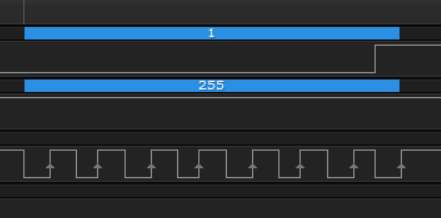

    Q1: The state of SIMO is not stable when it doesn't transmit data. Here is my test result. From the result, you can see that the state of SIMO before will not affect the sending data, because SPI of MSP430 is designed to be that data is changed on the first UCLK edge and captured on the following edge or data is captured on the first UCLK edge and changed on the following edge.
    Send 0x01:
    Send 0x00:
    Send 0x80:
    Q2: The SPI is digital signal, it is 0 or 1 and can't be 0.5. You need to take this as a reference.
