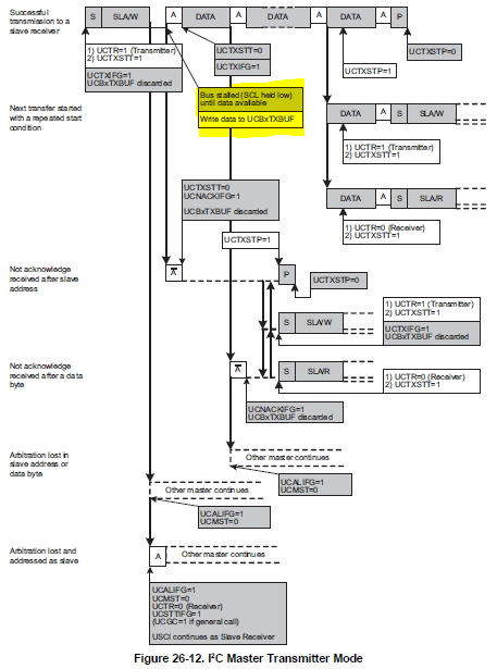

  • If you set UCTXSTT, but then do not write anything to TXBUF, the ACK clock cycle will not happen.

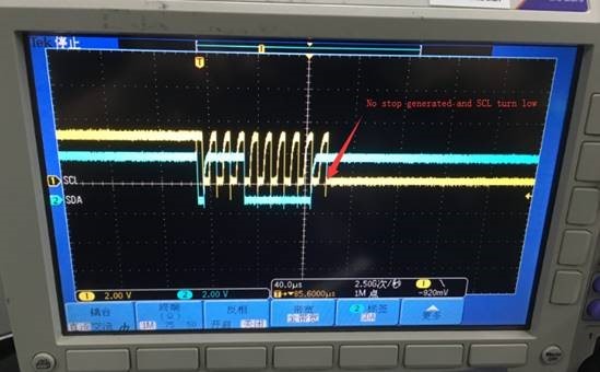

  • Here is some updating. Appreciate if someone could share me some comments.

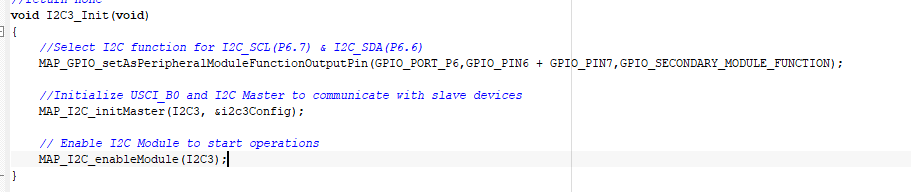

    1. Initial the i2c as the master mode with the function “No Autostop”
    2. the test code “only send slaver address” as below
    3. the result show that the slave address can be sent out. But the msp432 haven’t generated the STOP and the SCL turn low

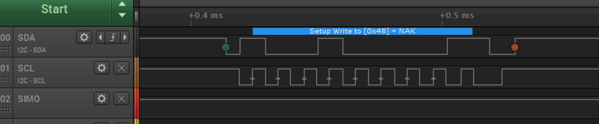

    Log got from the i2c monitor

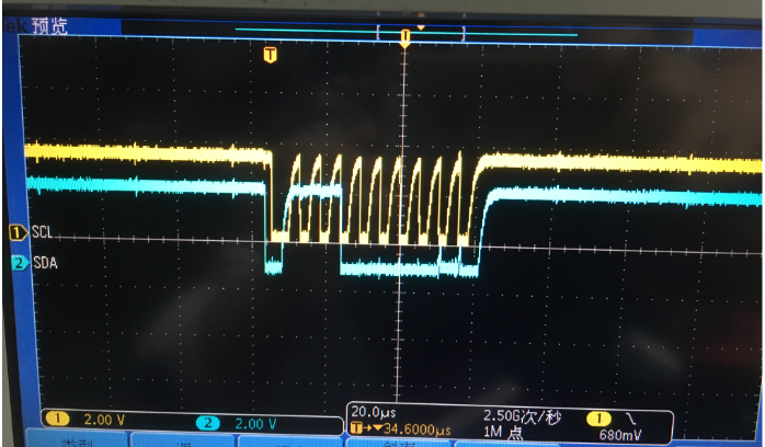

    4. attach the normal result got from another i2c master device
    waveform
    log got from the i2c monitor
        As Clemens indicated, you must write to the TX buffer inorder for the ACK to be sent and the communication to continue.
    I have attached a piece of code that simply writes the stop after the API which loads the TX and the start.
    I do not have a slave device to 'ACK' the signal.  Can you please confirm this on your side?

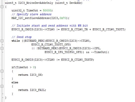

    thanks for your reply. after changing the code  "set the bit TXSTT(to send start) and TXSTP(to send stop) in meanwhile " (shows as below screenshot), i can got the result which i want. but i don't know if there is any risk to this coding. appreciate if you could share us some comments.
    test code
    waveform
    data log got from i2c monitor
  • The images did not upload properly. Please retry.
    I do have some concerns that this is not the intended flow of the state-machine in the device and it may possibly hang. In the code I provided it was a simple loop and I did not see any issues, but I did not test completely since I am missing an actual slave and the ACK. If you can protect the 'hello all' command by disabling interrupts that would help ensure consistent operation.
