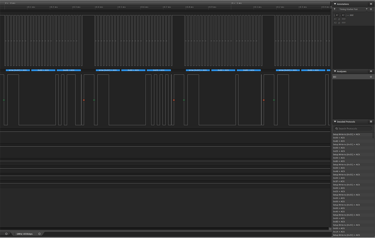

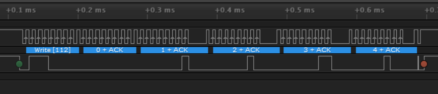

Now for the outputs, this is using the default clock (1MHz) and 400kbps I2C:
And this is using the default clock (1MHz) with 100kbps I2C:
If I change the I2C clock to 100kbps, or change the system clock to anything but the default 1MHz, EUSCI_B_I2C_masterSendMultiByteStart ignores the first byte. Why is this happening?
