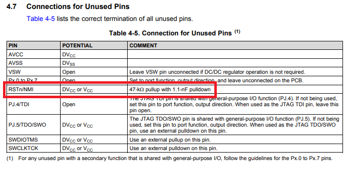

I have question about of the RSTn of MSP432P411V.
As described in the figure below, how to treat the RSTn terminal, I want to reduce the capacitor for noise reduction.
Can I use 1uF instead of 1.1nF?
H.U
