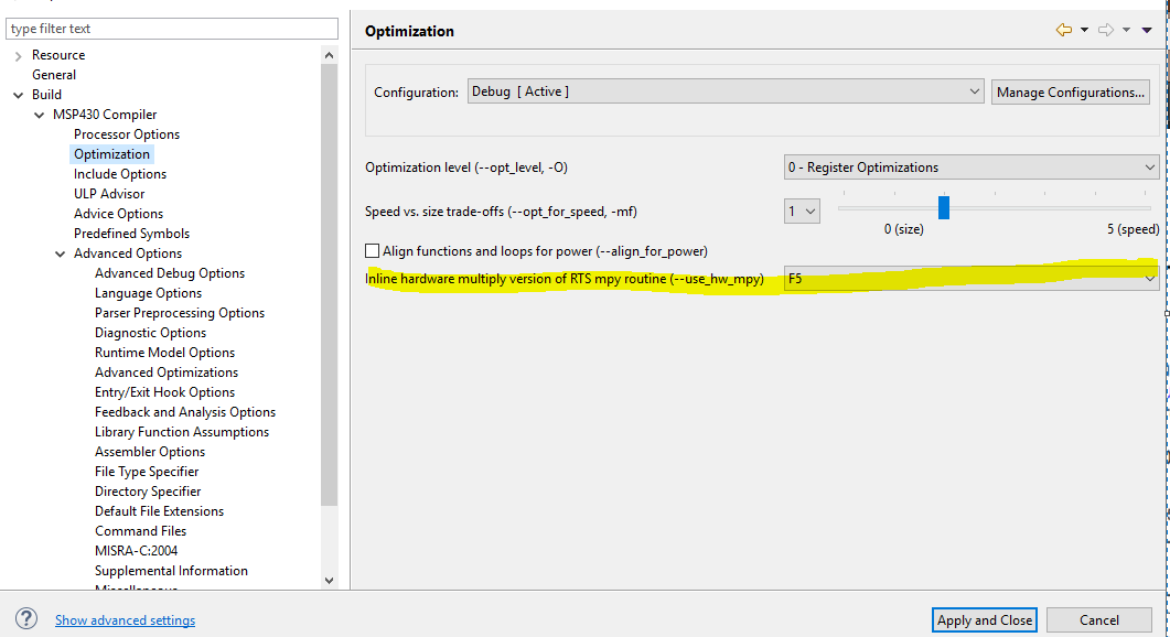

  • Hello Peter,
    In short, the MPY32 peripheral performs integer and fixed point math.
    It can be enabled/disabled in CCS as shown here.
      If you are doing floating point calculations you want to disable the hardware multiplier and  use the MSPMATHLIB library.
