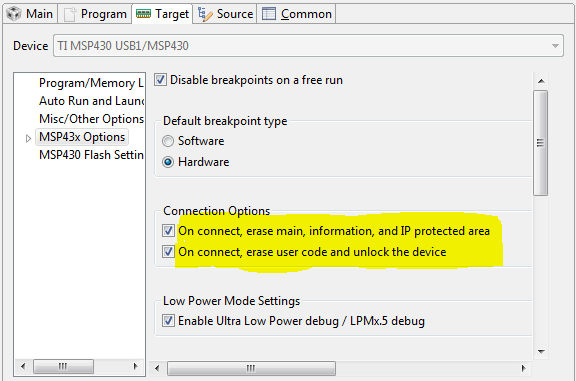

    I have managed to lock the spy-by-wire interface by writing password at 0xff80 to 0xff83. I have also managed to unlock the spy-by-wire interface using CCS 8.2.0. In debug configurations { Target->MSP43x options->"on connect erase the user code and unlock the device" } option erases the entire code and unlocks the device . But I need to unlock the device using password only!!! . please provide some suggestions...
  • what do this highlighted option in the image indicate??

    Thanks for your detailed replies. To answer your question, you can lock the JTAG using the JTAG interface but can only unlock it using the BSL interface. According to Section 2.2.3 in the MSP Code Protection Features app note:
    To clear JTAG/SBW lock protection, the bootloader can be used to clear the JTAG signatures to 00000000h or FFFFFFFFh. The BSL is password protected and the last 32 bytes of the interrupt vector table (FFE0h–FFFFh) are used as the BSL password (see Section 4). Unlocking JTAG/SBW access can be easily performed with the BSL mass erase command on these FRAM devices, because the JTAG signatures are located in main memory (rather than some protected BSL area like on F5xx/F6xx).
    I hope this helps!

  • Hi James,
    Does the "on connect erase the user code and unlock the device" performs mass erase on the device??. does the MSP-FET430UIF support bsl interface???.
  • Hello Gourav,
    Yes, that option in CCS does erase the device as long as you haven't power cycled it. Also, the legacy MSP-FET430UIF does not support BSL unfortunately, but our recommended MSP-FET does. You can learn more on our BSL page.
