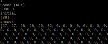

I am trying to connect Raspberry pi 3 B + with the MSP430f5529 (launchpad) using SPI communication but I seem to encounter an error I can't get around.
The SPI communication is a 3 wire connection with the Raspberry being the master and the MSP the slave. I have made sure that all the SPI parameters are OK (clock polarity and phase, etc...). The program consists simply in the raspberry sending a command (TX_CMD) in order to make the MSP read a sensor (not implemented yet, simulated as an array being modified) and then send back 4096 bytes (maximum supported by Raspberry buffer).
The problem is that the MSP sends twice the first byte to transmit (after receiving the TX_CMD), so the last byte is not sent. I have also seen that when I increase the SPI CLK frequency, more than just the first byte is sent twice. I thought it might be the SYS clock not being able to keep up with the SPI interrupt frequency, but after increasing the MCLK speed to 20MHz I stilll have the same error. The program runs fine for low frequencies, but are too low for an SPI communication (around 120KHz).
I don't usually post in forums, if any info is required just ask. I leave the code here:

Correct at 180KHz:
First byte twice at 500KHz:
More bytes repeated at 3MHz:
Thanks in advance.
    Just see your code, I have a question:
    It seems that TxBuff[3] should be 2 and TxBuff[4] should be 0 . But in your result, they are all different, why?
    If you doubt the MCLK is too slow, the data should all be sent twice. can you use a simple example to test?
    Eason
    Regarding the question about TxBuffer, TxBuffer[3] is filled with a new number on every SPI comunication (when the program enters into de if) so in the first photo it's value is 23 because I had done 23 SPI communication attemps before taking the screenshot. It is true that TxBuffer[4] should be 0 (like on the first picture), but in the other pictures one or more bytes are repeated in the SPI communication so the sent data is all shifted (filling TxBuffer[4] with previous values). You cant see it in the pictures I attached but the value 32 of TxBuffer[4095] appears in the first picture but not in the last two pictures due to this byte repeating issue.
    About the second question, I tried the MSP430F55xx_usci_spi_standard_slave.c code from Resource Explorer for MSP430F5529. In fact, the code shown here uses all the initialization functions from the example code.
    Thanks.
    I still have a question:
    What's the delay time between every two byte? Can you use a oscilloscope to catch the wave?
    What I mean is that:
    1. Your normal MCLK = 16Mhz, you doubt the MCLK is too slow, why don't you change MCLk to 25Mhz?
    2. a simple example(just make it to tranmit 0~ 4095, not a lot of same number) will help you know whether it is all OK from byte 6 to byte 4095.
    3. It is hard to explain the third result, it transmit 28 twice too.
    My advice:
    1. Since Speed=180kHz is OK, why not find a critical speed in which it sends 27 twice. And increase the MCK from 16Mhz to 25Mhz. If it just sends 27 once, you can know the reason is that the MCLK is too slow.
    2. When MCU enter the interrupt, it will take about 6 times MCLK latency, and out of interrupt will take 5 times MCLK latency. Running the code will also take some time. It is obvious that SPI clk=3Mhz is too fast.
    3. If you what to use a fast SPI, you should not use interrupt. Also using DMA will be much helpful.
    Eason
    I've tried all the things you specified in the last message and the solution was not to use interrupts. Without interrupts (using while(!(UCA0IFG & UCTXIFG));) I have achieved a spi frequency up to 8MHz without errors.
    Thanks for the help.
