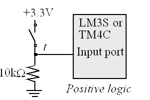

Hi all,
 I have tried to implement a positive logic in an onboard switch(P1.3) in MSP430G2 launchpad, I want it to be done by enabling the internal pulldown resistor, I tried the code below but it didn't work as I expect,
can anybody provide a solution for this issue,
int main()
clock_init();  // disable watchdog timer
P1DIR = 0X00;
P1DIR |= BIT0 + BIT6; //P1.0 and P1.6 output
P1OUT &= ~BIT3;
P1REN |=BIT3;
//int count =0;
P1OUT |=BIT0;
while(1)
if(!(P1IN & BIT3))
P1OUT ^= BIT6;
delay_ms(100);
else
P1OUT &= ~BIT6;
P1OUT ^= BIT0;
delay_ms(100);
return(0);
The logic I tried to implement was when the switch is pressed P1.0 should blink
