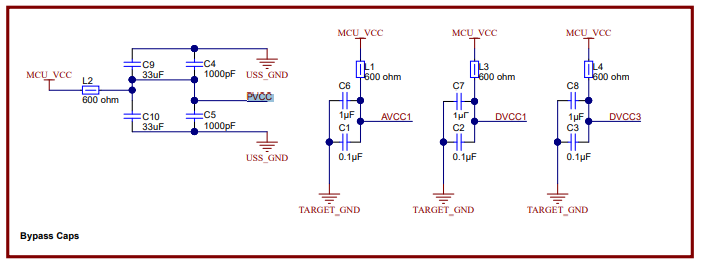

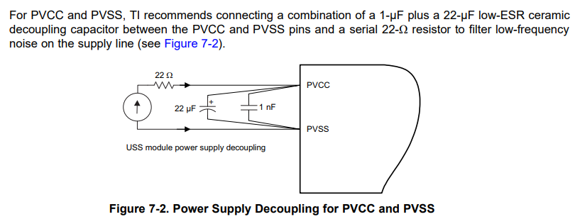

I am laying out PCB for MSP430FR6043 chip. This chip now has two PVCC pins between the inputs for the ultrasonic transducers. The EVM430 board uses a 6047 chip however that chip only has one PVCC input pin. Should the pins on the 6043 chip be tied together and then decoupled with a single capacitor/inductor network? Or should each PVCC pin be decoupled with its own cap/inductor network?? Also the data sheet shows a much simpler decoupling network than what is used on the EVM board. Is the data sheet version adequate or is the more robust EVM network needed??
