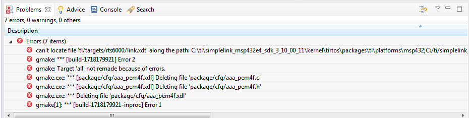

Hi All,
I have MSP-EXP432E401Y evaluation board and I tried to run sample code on this and it works fine.
Now I am trying to create one new RTOS based project in CCS Version: 8.3.0.00009 , xdctool "xdctools_3_51_02_21_core", and "tirtos_msp43x_2_20_00_06".
I have referred "TI-RTOS Kernel (SYS/BIOS) User's Guide" document (Section 2) for creating new project. But I am getting below error while building project, any help will be appreciated...
**** Build of configuration Debug for project aaa ****
"C:\\ti\\ccsv8\\utils\\bin\\gmake" -k -j 4 all -O
Building file: "../aaa.cfg"
Invoking: XDCtools
"C:/ti/xdctools_3_51_02_21_core/xs" --xdcpath="C:/ti/simplelink_msp432e4_sdk_3_10_00_11/source;C:/ti/simplelink_msp432e4_sdk_3_10_00_11/kernel/tirtos/packages;" xdc.tools.configuro -o configPkg -t ti.targets.arm.elf.M4F -p ti.platforms.msp432:MSP432E401Y -r debug -c "C:/ti/ccsv8/tools/compiler/ti-cgt-arm_18.1.4.LTS" "../aaa.cfg"
configuring aaa.xem4f from package/cfg/aaa_pem4f.cfg ...
subdir_rules.mk:12: recipe for target 'build-1718179921-inproc' failed
js: "C:/ti/simplelink_msp432e4_sdk_3_10_00_11/kernel/tirtos/packages/ti/targets/linkUtils.xs", line 84: xdc.services.global.XDCException: xdc.FILE_NOT_FOUND: can't locate file 'ti/targets/rts6000/link.xdt' along the path: C:\ti\simplelink_msp432e4_sdk_3_10_00_11\kernel\tirtos\packages\ti\platforms\msp432;C:/ti/simplelink_msp432e4_sdk_3_10_00_11/source;C:/ti/simplelink_msp432e4_sdk_3_10_00_11/kernel/tirtos/packages;C:/ti/xdctools_3_51_02_21_core/packages;..;
"C:/ti/simplelink_msp432e4_sdk_3_10_00_11/kernel/tirtos/packages/ti/platforms/msp432/linkcmd.xdt#93(eval)", line 1
"C:/ti/simplelink_msp432e4_sdk_3_10_00_11/kernel/tirtos/packages/ti/platforms/msp432/linkcmd.xdt", line 93
"C:/ti/simplelink_msp432e4_sdk_3_10_00_11/kernel/tirtos/packages/ti/platforms/msp432/linkcmd.xdt", line 134
xdctools_3_51_02_21_core\gmake.exe: *** [package.mak:202: package/cfg/aaa_pem4f.xdl] Error 1
xdctools_3_51_02_21_core\gmake.exe: *** Deleting file 'package/cfg/aaa_pem4f.xdl'
xdctools_3_51_02_21_core\gmake.exe: *** [package/cfg/aaa_pem4f.xdl] Deleting file 'package/cfg/aaa_pem4f.h'
xdctools_3_51_02_21_core\gmake.exe: *** [package/cfg/aaa_pem4f.xdl] Deleting file 'package/cfg/aaa_pem4f.c'
js: "C:/ti/xdctools_3_51_02_21_core/packages/xdc/tools/Cmdr.xs", line 52: Error: xdc.tools.configuro: configuration failed due to earlier errors (status = 2); 'linker.cmd' deleted.
gmake[1]: *** [build-1718179921-inproc] Error 1
subdir_rules.mk:9: recipe for target 'build-1718179921' failed
gmake: *** [build-1718179921] Error 2
gmake: Target 'all' not remade because of errors.
**** Build Finished ****

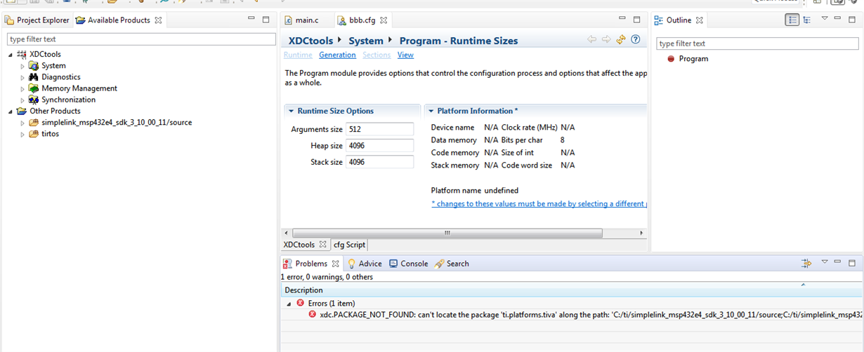

  • I am getting only "Program" option in .cfg file of my project . Check in attached image of my project...
  • I expect the platform or target incorrect. Can you import an example from the SDK and confirm you can build it? Assuming that works, please look at the following for both the imported example and the project that has aaa.cfg.

    I think that the error message about link.xdt file is masking another, more relevant error message. It would help if you could zip up your project right after a failed build, and then post it here. If there are any source files you can't post publicly, please exclude them from the zip file.

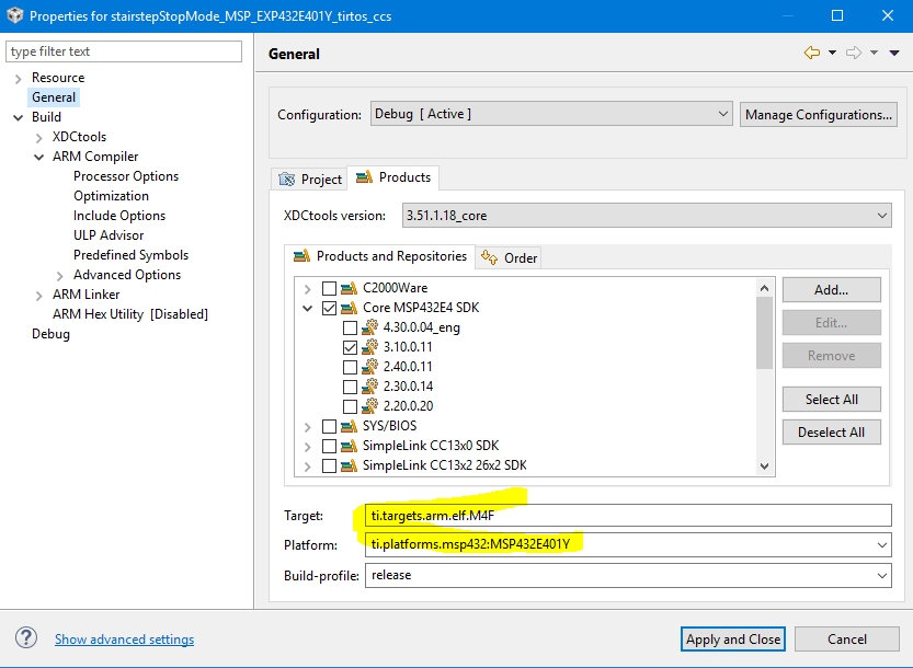

    I crossed checked platform & target of my RTOS project i.e. "aaa" with the project that I have imported from example; both have same platform and target files.

  • Hi Tanvi,
    Thanks for the info. I looked at your project and there are various issues. It looks like you started with a driverlib example (or some non-TI-RTOS example) and tried adding TI-RTOS to it. While this is doable, it is not the recommended approach. I think you should import a basic TI-RTOS example (e.g. drivers/empty) and make sure it works (which is sounds like it will) and then add you content into it.
    Here is the list of things I see wrong with your project (and most will be resolved if you start with a TI-RTOS example)
    1. You have multiple products select. Note: ignore that mine says "Core MSP432E4 SDK". It is really SimpleLink MSP432E4 SDK...it's the way we do it internally at TI).
    2. The .cfg is empty.
    3. You are supplying a vector table. TI-RTOS manages this for you.
    4. While similar, you linker file is missing some things.
    5. No call to BIOS_start in main().
    Todd

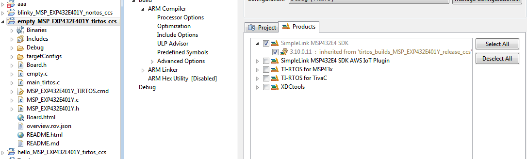

    2.) As you guided that I have selected multiple products, I have de-selected TI-RTOS and keep only 'SimpleLink MSP'  product selected. Buiding of the project was giving me same errors.
    Check below screenshots:

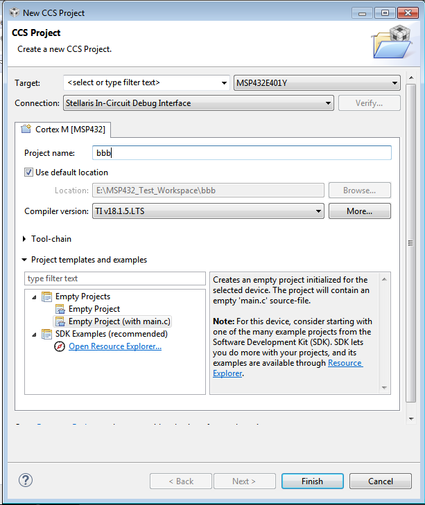

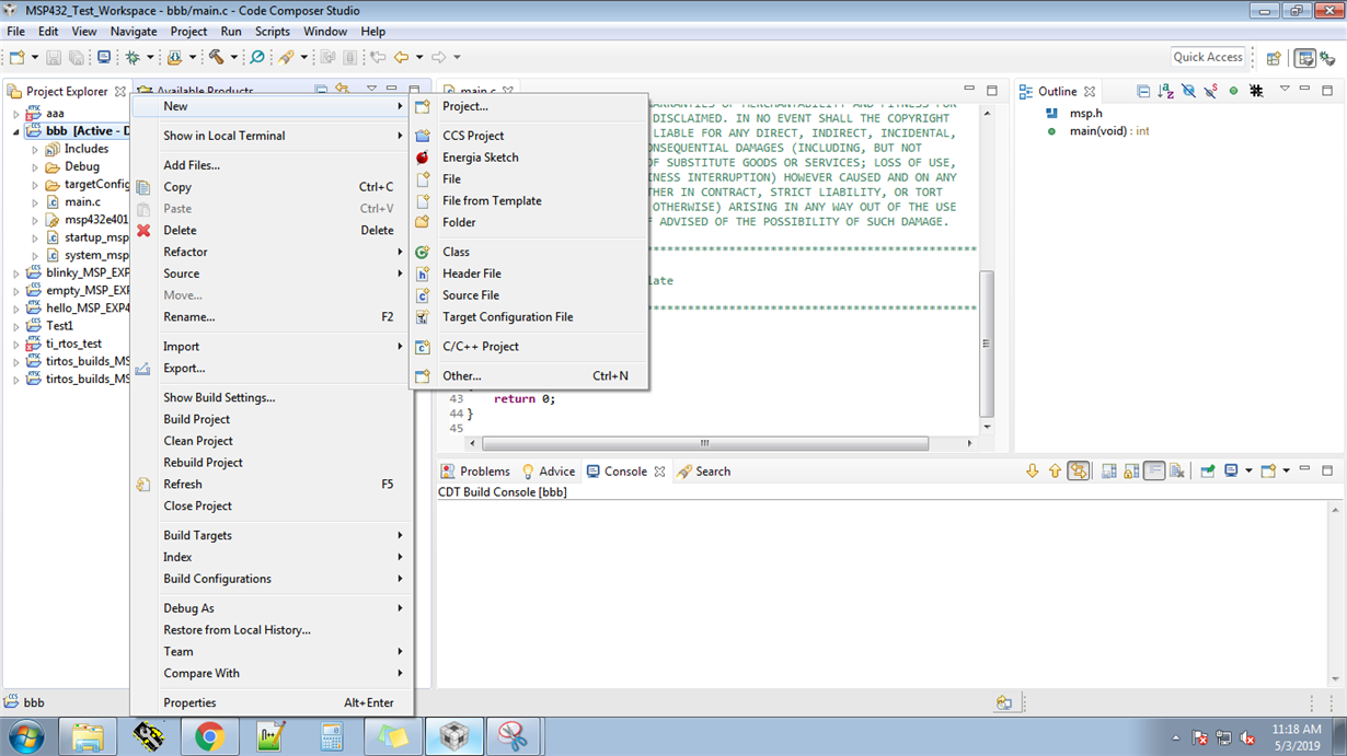

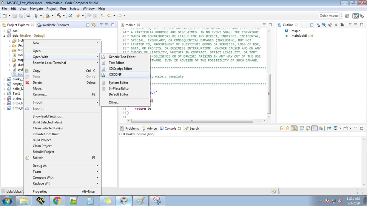

    3.) Now I have tried to create one new RTOS based project, namely 'bbb',  in current workspace. Check the screenshots below of creating new RTOS based project steps:
    Note: This gives me "PACKAGE NOT FOUND" error if I deselect TI-RTOS product but if I select TI-RTOS product then it won't give this error.

  • Dear All,
    I found that I have another ARM compiler in the PC. I changed the folder name of that compiler, and then the TI-RTOS example project can be compiled correctly.
    Sunglin.
  • Tanvi,
    Importing a TI-RTOS example (e.g. drivers/empty) is creating a new project. We recommend this approach. Starting with the CCS new project wizard and creating an empty one is like getting bags of cement to make a foundation for a house. Importing the drivers/empty example, is getting the foundation already made (and made properly).
    Once you have the project, you can add the include paths and library for lwIP. Note: we have not wrote the port for lwIP on TI-RTOS. We have for FreeRTOS. For TI-RTOS, we recommend using the NDK. There are examples for the NDK on TI-RTOS already (e.g. TCP Echo).
