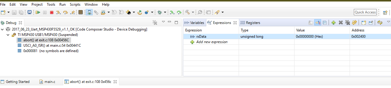

    Generally i connect the Ping to my MSP430F5529 using the UART wires, and then i Debug the earlier code and here is where i would like to read the measurement.
    You can see below what i have as a result and the wiring between the two devices :
    This is an image of the wiring :
    When i debug and i resume the executing code i get as result the capture below:
    And then i click on the halt option i get this :
    which prove that there is no data to be read on the RX buffer
    Thank you for any help further,
    Zouhir EROUCH,
  • Zouhir,
    First, I don't see the ping having a ground connection on the launchpad. Can you double check the wiring there?
    Once the wiring is confirmed, can you scope the data lines from the ping and confirm that it is actually even sending data? Is it just supposed to stream data out, or do you have to do some handshaking first to configure it?
    If you can confirm that it is actually sending data, I would then encourage you to put a break point in your ISR. This way you can see when the interrupt occurred and see exactly what data was read out of the RXBUF.
