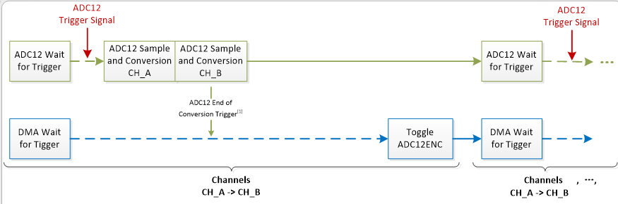

The problem is, that if I set the MSC bit, the ADC keeps sampling continuously, ignoring the EOS bit, not waiting for a trigger.
If I don't set the MSC bit, ADC converts only one input for each trigger from the timer, so that the ADC interrupt hapens only after nine triggers.
  • Hi Marko,
    You could implement this by Sequence-of-Channels Mode (Autoscan Mode) with Multiple Sample and Convert Mode(ADC12MSC = 1). Each trigger will let all the 9 channels be sampled-and-converted. After each sequence, you could use DMA to toggle the ADCENC bit automatically and then wait for next trigger event.
    A flow chart for 2 channels is shown below for your reference.

  • Hi Marko,
    What I means for "toggle the ADCENC bit automatically" is that the CPU doesn't need to wake to run code for toggling.
    1. DMA0 to be triggered by ADC12IFGx when ADC completes the sequence conversion. Then DMA0 copies a constant value to ADC12CTL0 with ADCENC disabled.
    2. DAM1 to be triggered by DMA0. Then DMA1 copies a constant value to ADC12CTL0 with ADCENC enabled.
    You could configure the DMA0&1 when initial the MCU and then let it run. Every ADC12IFGx could trigger the steps above to toggle the ADCENC after every sequence of conversion without any code running.
