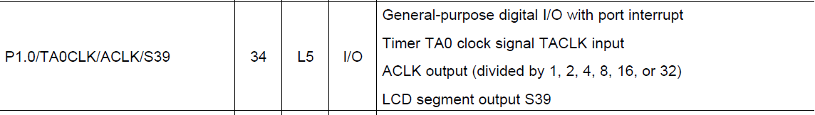

    but In My controller(MSP430F6638) there are multiple outputs at the same pin... what to do?
    Can we use "GPIO_setAsPeripheralModuleFunctionInputPin" function with MSP430F6638 controller. because as i read the document of driver library it says "Note that MSP430F5xx/6xx family doesn't support these function modes."
  • Hi Mohit
    The "Note that MSP430F5xx/6xx family doesn't support these function modes." means MSP430F5xx/6xx family don't support the third parameter of this function. We can just use the function like this and don't need add the third parameter:
    GPIO_setAsPeripheralModuleFunctionInputPin(
    GPIO_PORT_P6,
    GPIO_PIN0
