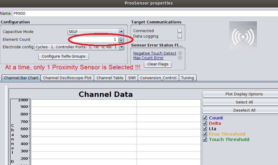

I have below doubts regarding usage of "Captivate High Sensitivity Proximity Panel". (Attached the image as reference )
1) Where do I start learning using your APIs, for writing code using CCS. Like sample Hello World, different APIs, etc.
2) Where do I refer any sample example for accessing Capacitance data from all three proximity sensors at a time ( Left , Center & Right Zone Sensors).
3) Using design studio I tried connecting this Board with Proximity sensor  and  following is my observation
- In Self / Mutual Capacitive mode, I always get Element Count as "1". I cannot increase the sensor element.
- Due to which at any time I get Capacitance values only from "Left Zone"
- How do I ensure I get Capacitance values from all the 3 sensors ( Left / Center / Right Zone Sensors).

  • Hi Ling,
    Thank you for the inputs. I have installed DesignCenter 1.60. and also ran the ProximitySensor Code Example using CCS. But, the issue is still not resolved.
    I tried connecting this Board with Proximity sensor DesignCenter 1.60  and  my observation is same as above.

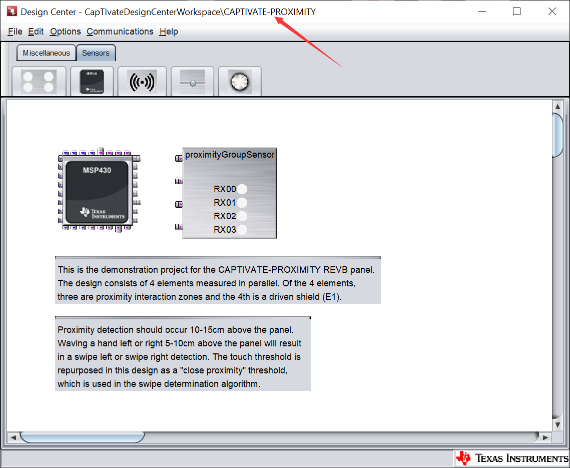

    As shown in your Help Topics, I cannot find the "proximityGroupSensor" element in the DesignCenter, due to which I can only create 1 Proximity sensor at a time and hence data is received only from Left Zone sensors. I guess, this is the main problem, unable to locate / find proximityGroupSensor in the DesignCenter, hence cannot access all the Three zones at a time.
    Appreciate your Inputs to resolve the issue.
    Please find attached images to get better information.
    Sujit

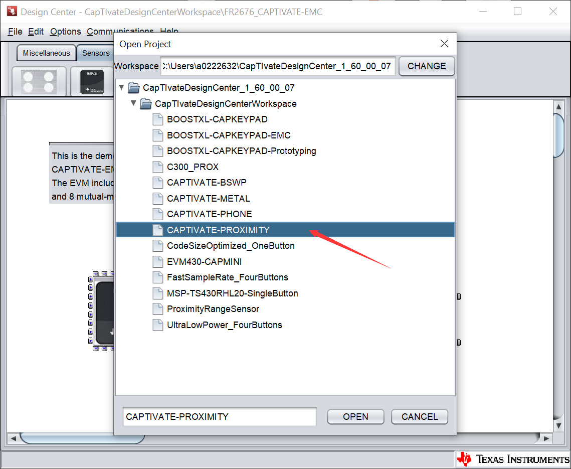

  • Hi Sujit,
    There is a example project in Design Center, File -> Open...
    Ling
  • Hi Ling,
    Thank you for detailed explanation. This resolved my issue. I am able to get the data values from each of the Left / Center / Right Sensor.
    Also, would like to know following:
    1) What is the process to create the "proximityGroupSensor" as shown in above image.
    2) How do I extract Capacitance Change Value in picofarad for each of the Left / Center / Right Sensor.
    Thank you.
    Sujit
  • Hi Sujit,
    Pleaese refer to workshop session of technology guide.
    software-dl.ti.com/.../ch_workshop.html
    This is online version, you can also find the local version from Help->Topic.
    Ling
