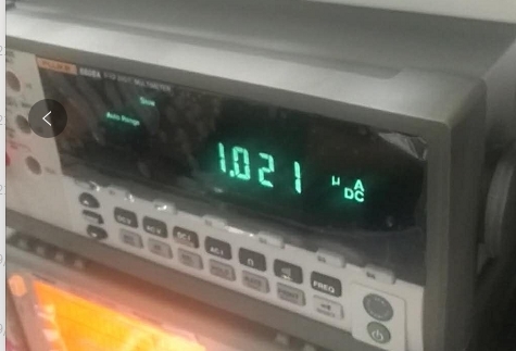

1 Without using  ADC the power consumption is  around 1.02uA .

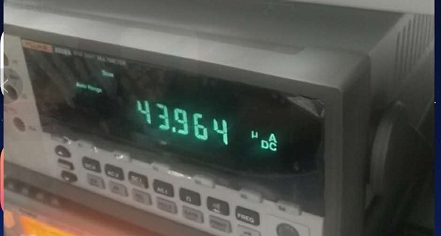

2 My custer closed the ADC after ADC acquisition, but  the CPU power will jump to 43.964 uA.
My question isHow to reduce the power consumption to 1.02uA?

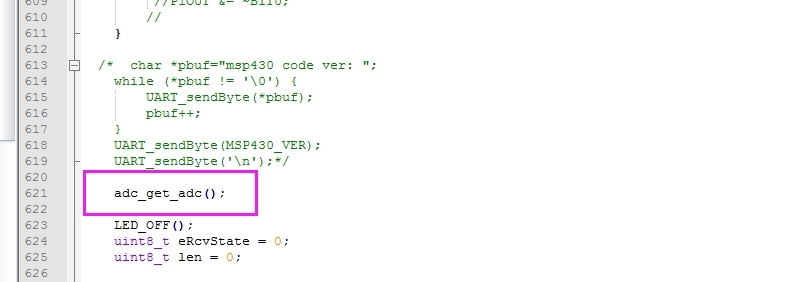

3 ADC acquisition code is as follow:
uint16_t adc_get_adc(void)
    int retry = 10;
    int count = 0;
    uint32_t adc_sum = 0;
    ADCCTL0 &= ~ADCENC;                     // Disable ADC
    ADCCTL0 = ADCSHT_2 | ADCON;             // ADCON, S&H=16 ADC clks
    ADCCTL1 = ADCSHP;                       // ADCCLK = MODOSC; sampling timer
    ADCCTL2 = ADCRES;                       // 10-bit conversion results
    //ADCIE = ADCIE0;                         // Enable ADC conv complete interrupt
    ADCIE = 0;
    ADCMCTL0 = ADCINCH_13 | ADCSREF_0;      // A13 ADC input select = 1.5V Ref
                                            // Vref = DVCC
    // Configure reference module located in the PMM
    PMMCTL0_H = PMMPW_H;                    // Unlock the PMM registers
    PMMCTL2 |= INTREFEN;                    // Enable internal reference
    while(!(PMMCTL2 & REFGENRDY));          // Poll till internal reference settles
    while (retry--) {
        uint16_t adc = 0;
        ADCCTL0 |= ADCENC | ADCSC;
        __no_operation();
        __delay_cycles(1);
        adc = ADCMEM0;
        if (adc > 0) {
          adc_sum += adc;
          count++;
    ADCCTL0 &= ~ADCSC;
    ADCCTL0 &= ~ADCENC;
    ADCCTL0 &= ~ADCON;
    ADCCTL1 &= ~ADCSHP;
    ADCMCTL0 &= ~ADCINCH_13;
    PMMCTL2 &= ~INTREFEN;                       // Disable internal reference
    PMMCTL2 = 0;
    return count > 0 ? adc_sum / count : 0;

    1. We found that as long as the ADC acquisition code was called, the CPU power would jump, and if the ADC code was not called, there would be no jump. The normal power consumption was maintained at about 1.02uA. The specific ADC acquisition code is as follows, ADC is normally closed after the call, but the power consumption is still jumping. 43uA is the current at the time of jump, approximately 10s from 1.02uA to 43uA, and 43uA is the instantaneous power consumption.

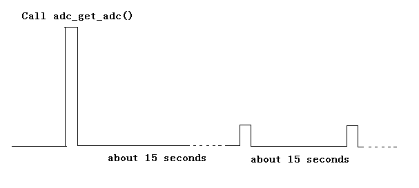

    Could you give me more information about the test/running condition of the two different power consumption?
  • Hi Wei.Jetim,
         Thanks for ur repley.
    1  The power jump depends on whether the function adc_get_adc() is called. If the function is called, there will be a power jump. If it is not called, there will be no power jump.
    2 See the attachment for the code details

    	adc_get_adc();
        LED_OFF();

                                   if (uart_data[4] == 1) {
                                      adc_result = adc_get_adc();
                                   } else {
                                      adc_result = adc_ide;
                                   uart_respon_data(COMMAND_GET_ADC,(void*)&adc_result,sizeof(adc_result));
                                   break;

  • Hi Bruce,
         Thanks for your reply.
         1  My question is that:
     After the call of adc_get_adc()  function, the power consumption decreases. But the power consumption jump will occur every period of time (about 15 seconds)after that , just as the follow pic shown.
    Note: we are using LPM3 mode.
        2 The streamlined testing code is as the attachment.
