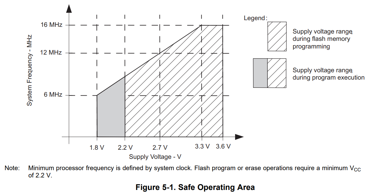

we use MSP430G2433 in our Zebra product [MC18 cradle]. we write and read certain memory area in the segment B [2nd segment]. we have a customer who complains that whatever is being written to this area is not being read back, when we read it back, it gives incorrect values.
Need help in resolving this issue on priority as customer operations is impacted due to this issue.

    What's more, could you help me to check if your using condition is under our recommended condition in the datasheet 5.3 that is mainly about power supply and operation frequency. www.ti.com/.../msp430g2433.pdf

    Could you make sure your power supply is stable and above 3.3V? What's MCLK frequency do you use?

    The power supply is stable, MCLK freq is 8MHZ.

  • Also, we see that JTAG read/writes are more stable then done programitically? Can we know what could be the difference, is this a timing related thing?
    Rajat
  • Hi Rajat
    What's power voltage do you use? You just say it is stable but not mention what's the voltage value. What I want to do is to confirm your operation is in safe area
  • Hi Gary,
    Please find the input voltage range.
    Channel : INCH_11
    ADC10AE0 |= BIT3 + BIT0;
    ADC10CTL1 = SHS_0 + ADC10SSEL_0 + ADC10DIV_2 + CONSEQ_2 + channel;
    ADC10CTL0 = SREF_1 + ADC10SHT_3 + REF2_5V + REFON +ADC10ON;
    #define MCU_VOLTS_MIN_ADC_VALUE 637
    #define MCU_VOLTS_MAX_ADC_VALUE 715
    Write operates between MCU_VOLTS_MIN_ADC_VALUE  and MCU_VOLTS_MAX_ADC_VALUE  only. So if there is a voltage variation, it is detected as an error, which is not in our case.
    Rajat
  • Hi Rajat
    What I want to check is the voltage of the VCC not the input of the ADC. What I show you the picture is the relation between MCLK frequency and VCC voltage.
    Best regards
    Gary
