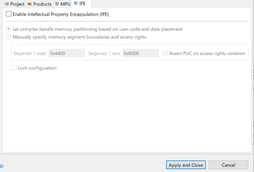

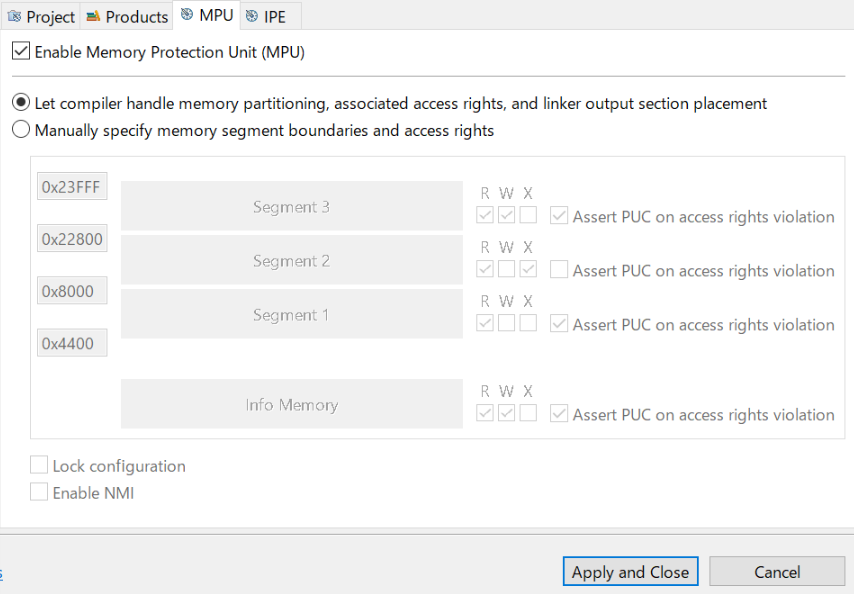

    By the way, our project uses MPU function.
    Could you please see our configuration?
    I attach CCS settings and snippet of source code.

    As an initial pass through of the source code for enabling the MPU, I noticed that the comments are different from what is actually happening.
    The MPUSAM register is being initialized so that:
    Segment 1 ( 0x4400 - 0x7FFF ) is Read and Execute
    Segment 2 ( 0x8000 - 0x227FF) is Read only
    Segment 3 ( 0x22800 - 23FFF) is Read only
    Info is Read only
    The comments are describing the segments to have different access rights than what is currently implemented.
    Another thing I noticed is that the line "MPUCTL0_H =0xA5;" is not needed, the only thing you need to do to access the MPU registers is the line of code right under it: MPUCTL0 = MPUPW;
    Has the customer been able to confirm similar behavior (unexpected verification failure) with TI Provided example code on their currently failing custom boards? If they are unable to recreate the behavior with the TI Example code then it would lead me to believe that some aspect of the source code is causing the verification failure.
