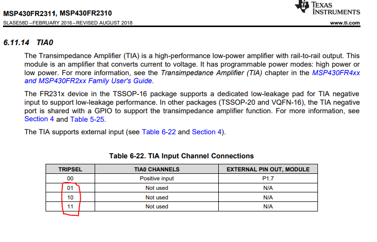

    In an effort to try to understand better your application, is there anything connected to P1.1?  I noticed comment about reference resistor.  I was wandering if you are using a voltage divider powered by P1.1 output and the the divider output is connected to P1.0 (v+ on the comparator).
    Also, regarding setting the following register bits, what is your intended purpose for your application?
    TRI0CTL |= TRIPSEL1 | TRIPSEL0;
    According to the datasheet, the configuration you chose is not used.

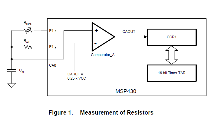

    regarding P1.1 , P1.0 ,P1.2  i am implementing  slope A2D   with comperator to calculate NTC Temperature resistor like
    Application Report  SLAA129B .
    .its a well known TI application. I used it many times  with PWM with a many TI processors and here  on MSP430FR2311  I got into trouble and cant implant  comperator  slope A2D   with  PWM.

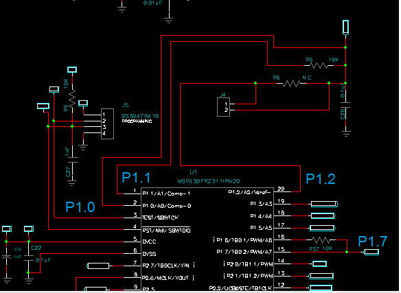

    here you can see this part on my scheme:
    regarding :TRI0CTL |= TRIPSEL1 | TRIPSEL0;
    I saw that there might be a connection to TIA  module and while trying  to find a solution I thought to disconnect P1.7 from TIA.
    Of course it did not help,,,
    Aharon.

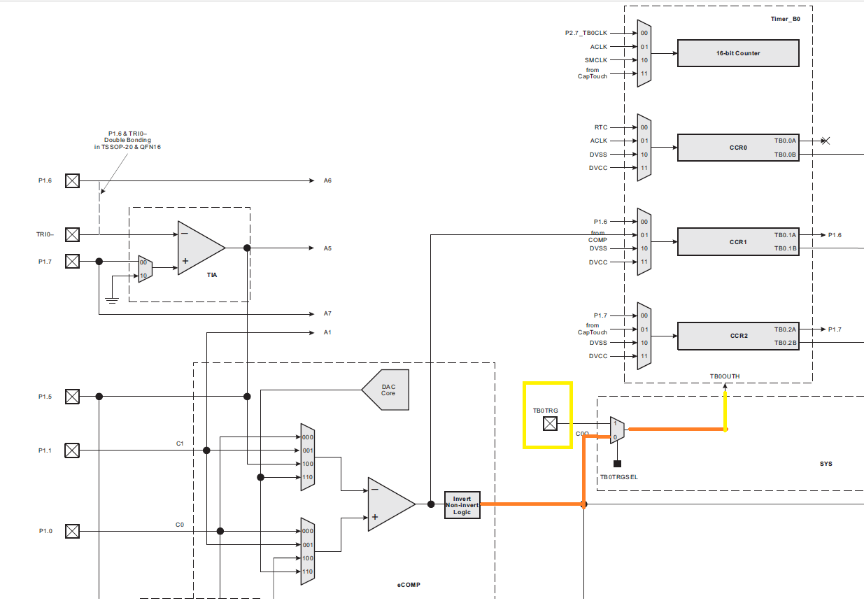

    I initially tried a very basic test of outputting a PWM on P1.7 (like you do in your SW) and running the eCOMP module with your settings. I saw a very similar, but different problem. When eCOMP is enabled, my PWM signal fell flat to 0V (as opposed to yours falling to 1V). When I disabled eCOMP, the PWM came back to life with no issue. Even though I didn't see the exact same problem as you, I saw very similar behavior.
    After looking around in our documentation, I came across the following:
    TB0TRGSEL is 0 by default - meaning that the eCOMP output can set the P1.7 timer output to high impedance.
    I set the TB0TRGSEL bit to 1, and I saw my PWM functioning normally with the eCOMP module was enabled. I think what we were both observing was the eCOMP module setting the PWM pin to a high-impedance state.

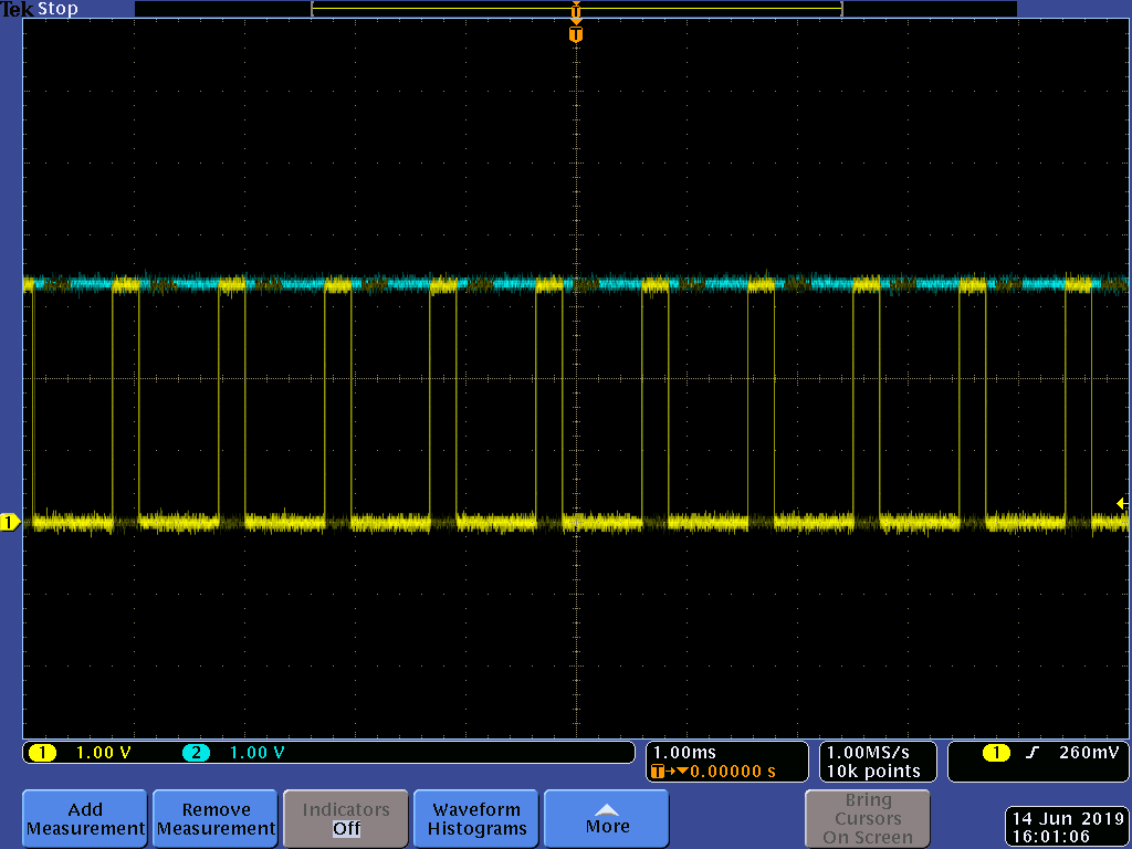

    Here is also a screenshot of my oscope measurements of the above SW. You can see the PWM signal is functioning at 3.3V (yellow) with P1.1 driven high (blue). eCOMP is also enabled with your settings:
    I think that if you include the SYSCFG2 |= TB0TRGSEL__EXTERNAL; line you will see normal PWM behavior (eCOMP will no longer be a high-impedance trigger source). Do not set the P1.2 function to TB0TRG. Since you are changing the timer high impedance source externally to P1.2, this could cause accidental high-impedance triggers. I configured P1.2 as TB0TRG in my SW for debug purposes only.
