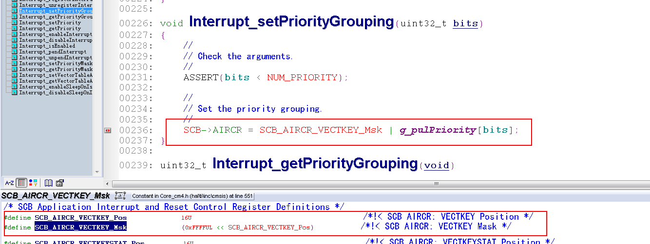

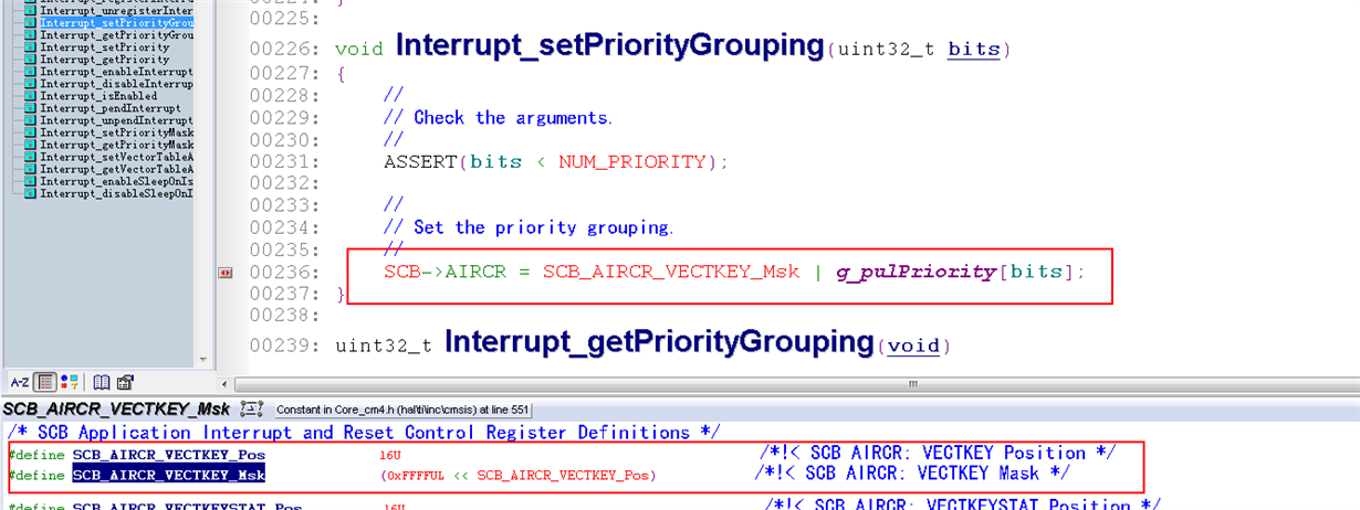

Let's forget the version of the driveLib,and focus on the code.
The problem is:the current dirveLib code doesn't use a writing KEY to write the register AIRCR
