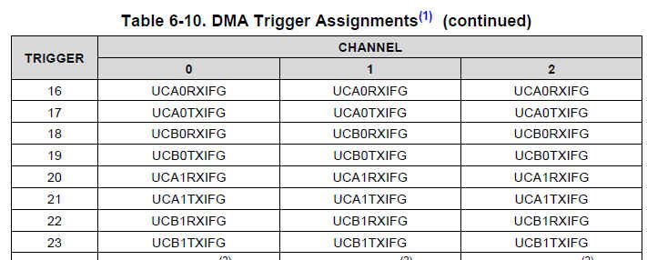

Since I'm not familiar with TM4C devices, I can't give much suggestion on that side with micro DMA. But for MSP430F5529, I suggest you to use "single transfer" mode in the DMA, and use UCA/UCBxTXIFG/RXIFG as the trigger source, as there isn't any buffer in the SPI and you need to send/read out the data before next arriving.
For the "single transfer" mode, you may refer to chapter 11.2.2.1 in the F5529's User's Guide. And also see below table captured from the datasheet for the trigger source.
Moreover, though the DMA mode is "single transfer", it still transfers a "block" of data in the SPI communication unless something interrupts it (such as other interrupt, CPU acitivities).
