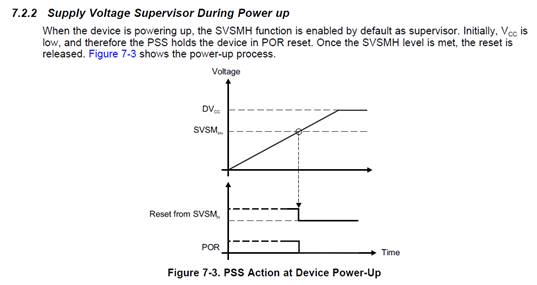

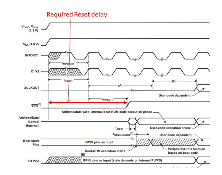

I have a question about RST pin input of MSP430P401M,
I think MCU usually requires some delay for RST deassertion during/after power-up like the below which is from C2000 MCU(!XRS is Reset input in this case).
Doesn’t MSP432 require this kind of delay for RST deassertion?
I could not find any information like that in the datasheet.
