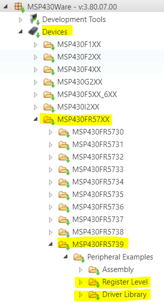

This is my first time working with a non-Arduino microcontroller, and I'm having a lot of difficulties.
I've been assigned the task to set some particular pins on this microcontroller as GPIO outputs, as well as to set some as ADC inputs. I also need to set up a UART on the chip's pins.
I did some research, and it looks like Code Composer Studio is what I should be using for programming this chip. I found some example code, which indicated that I need to use the DriverLib library. I'm trying to set up my project to assign a few pins as outputs. My code looks like:

When I try to build this with the little hammer icon in the upper left, I get this error, repeated a whole bunch of times for different particular files in the driverlib folder.
file "./driverlib/MSP430FR57xx/adc10_b.obj" specifies large code memory model, which is not compatible with small code memory model specified in a previous file or on the command line null: file "./driverlib/MSP430FR57xx/adc10_b.obj" specifies large code memory model, which is not compatible with small code memory model specified in a previous file or on the command line
What am I doing wrong here? I've been trying at this for three days and making very little progress...
