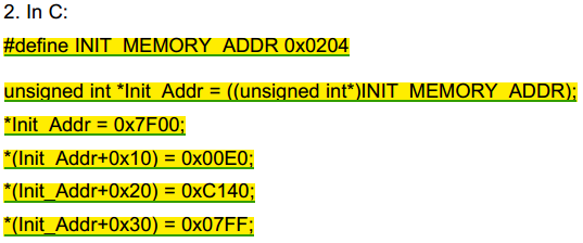

Now I have some problems when I test the MSP430F5342.
According to the slaz278ab,errata PORT24 says that there will be an increased current consumption because of the internal floating pads.
And Workaround gives the code in C to avoid the increased current consumption.
But the "#define INIT_MEMORY_ADDR 0x0204" in the slaz278ab->PORT24,as follow:
which differs from the "#define INIT_MEMORY_ADDR1 0x0206" in the slac504g\MSP430F534x_Code_Examples\MSP430F534x_LPM3_01.c,as follow:
Which one should I choose for the solution to the errata PORT24.
