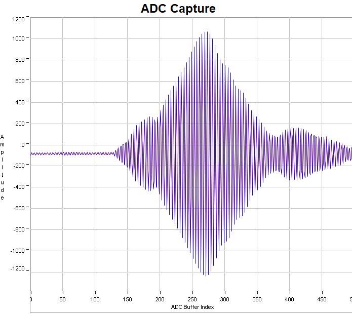

    2. I have enabled the USS_CALIBRATE_SIGNAL_GAIN_TEST and set the USS_AGC_CONSTANT to 60. On the ADC capture the signal is offset by about 70-80 units (see image attached). I was wondering if that can be adjusted using USS_ALG_CALIBRATED_UPS_DC_OFFSET? Again, please point me at the relevant part of the documentation if I am missing something. Any other recommendations on what parameters I could test? I saw a filtering capability but I have not tested it yet.

    In regards to the DC Offset, the GUI displays the ADC signal before the processing is applied, so no difference is seen in the GUI ADC capture.  It is recommended to use USS_APP_DC_OFFSET_CANCELLATION_ENABLE function.
    Since you have an offset, it is also recommended that you reduce the AGC constant so that you are seeing less than 1000 counts on the negative side of the signal.  This is to ensure you are not oversaturating the input.

  • Just wanted to follow up with some additional information regarding the DC offset.  If you want to view the offset that is applied, you can make the following change in USSLibGUIApp.c.  Notice that HMI_PostMeasurement_Update(); has been moved to be after run algorithms.  The GUI will now show the corrected DC offset in the ADC Capture tab.
                    // HMI function called after measurement and before algorithms
                    // are executed.
                    // Used to send ADC waveforms before manipulation
                   // HMI_PostMeasurement_Update();  //comment this out
                    code = USS_runAlgorithmsFixedPoint(&gUssSWConfig,&algResFixed);
                    if ( (USS_message_code_valid_results != code) &&
                         (USS_message_code_algorithm_captures_accumulated != code) )
                        //Invalid algorithm results, report error
                        USSLibGUIApp_send_error(COMMAND_HANDLER_ERROR_FAULT_ALG_ERROR,
                                                (uint16_t) code);
                    HMI_PostMeasurement_Update();   //move update here to view in GUI after DC offset has been applied
                    // HMI function called after algorithms are executed
                    // Used to send results of algorithms.
                    HMI_PostAlgorithm_Update(&algResFixed);
    Another note about using the DC offset cancellation function.  This needs to be enabled by uncommenting the #define USS_APP_DC_OFFSET_CANCELLATION_ENABLE in USS_App_userconfig.h.  After uncommenting, be sure that you also set the interval as well using the code below.  The default is 0(disabled).  The value you use will determine the interval based on measurement cycles.  If it is set to 1, this will be performed for every measurement, 2 is every 2nd measurement, and so on.
