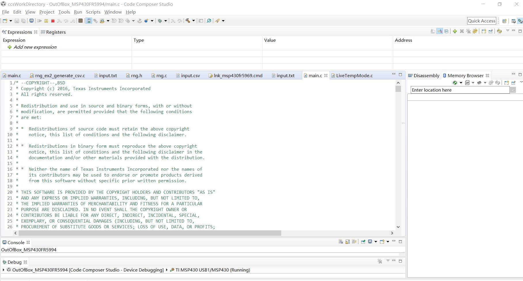

I am currently running the out-of-box demo. I run the out-of-box project code using CCS, which is shown in the below figure, and there is no breakpoints when I run.

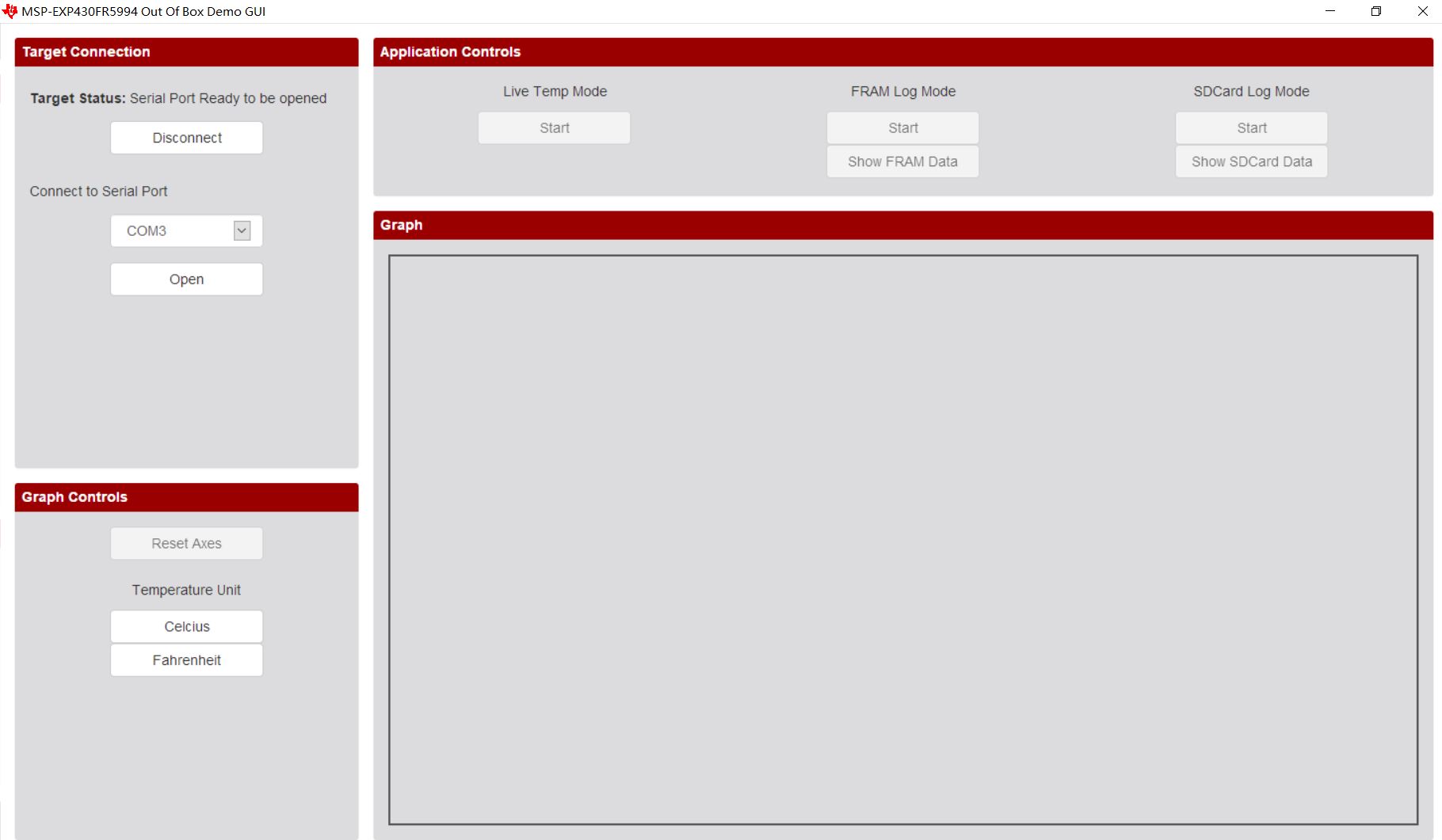

Also I have opened the GUI as follow:
However, when I pressed open button and the start button under "live temp mode", the gui does not show the graph and show as the following:
It continuously show the "serial port ready to be opened" and does not work to show the graph at any time.
I am so confused, am I doing wrong in the previous steps?

  • Hello Mingran,
    You are seeing this issue because the GUI takes advantage of the backchannel UART COM port which is unavailable when you are actively debugging the board in CCS.
    Please program the device, disconnect the debugger, restart the device, and then try running the demo. You should see that the GUI will maintain connection with the board and display live temp data when prompted.
    Section 3.1 of the MSP430FR5994 Launchpad Development Kit User's Guide has a step by step walk-through of running the out-of-box demo in case you need further clarification.
