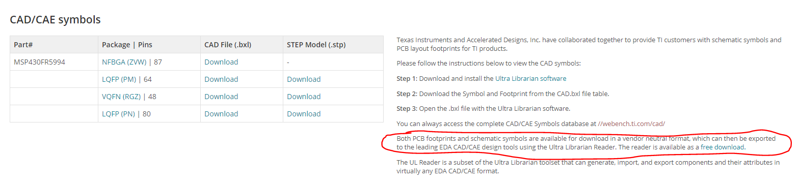

    You should use the Ultra Librarian software to export the PCB footprints and schematic for your design tools format from the downloaded .bxl file of LQFP(PN) | 80. I tried it for my Altium Designer 18 and it works well.

    This is a lot of trouble for customers who just wanted to search the pad library of their CAD tool for a matching footprint. In my opinion this should information should be part of the datasheet instead of requiring users to download UltraLibrarian (about 2Gb of disk space and comes with an  annoying upgrade nag screen to pay for an upgrade).   Most CAD tools come with pre-made library footprints so why do I have to use UltraLibrarian to get a footprint when I can just look it up? And why should I have to learn another tool chain ecosystem for information that should be part of the datasheet? If the footprint was completely different standard then yeah maybe but this is not the case with this LQFP. And why does TI make customers go through their "Where's Waldo" website jungle to find the small print that you circled above in red?

    And of course, we usually recommend customers to access UltraLibrarian across TI. I understand that this tool doesn't support your CAD tool, but it does solve many of these questions. I have followed up with UltraLibrarian to suggest support for your CAD tool (DipTrace, right?), but it's really up to them.
