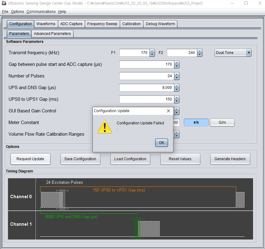

EVM430-FR6043 :EVM430-FR6043: Error message.
Part Number: EVM430-FR6043
The EVM430-FR6043 is used for gas flow.
http://www.ti.com/tool/MSP-ULTRASONIC-DESIGN-CENTER -> GET SOFTWARE FROM TI: MSP-USSSWLIB_Gas
USSSWLib_Gas Product downloads -> USSSWLib - USS-02_20_00_16-windows-installer.exe  ,
Gas Demo Application-UltrasonicGasFR6043_02_20_00_07_windows_installer.exe
I downloaded two software from the Ti site.
 Make a USB connection. USS runs and displays an error.
I get an XML parsing error.
Press F1 and press Request update.
To tell you the solution.
    I saw at the bottom of USS GUI, it shows HID disconnected. Can you confirm you get a functional USB connection between the EVM  and your PC? Please try if you can download code successfully to the EVM board first.
